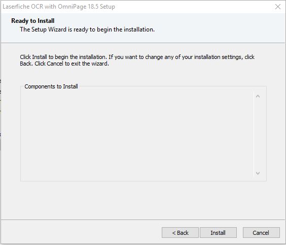

Just upgraded my LF server from 9.1 to 9.2. During the 9.2 client install, the OCR engine failed to install. I attempted to install the OCR engine from the seperate folder location and that also failed. I am currently using Win10. Any Ideas? I have uninstalled, reinstalled and repaired - no luck

The initial error stated: OCR Failed - during the 9.2 client install. When I attempted to run the LF OCR OmniPage 18.5 setup, the Components to Install section is blank (see attachment).
replied on October 20, 2016
OCR is part of the client install.  Are you running the client installation from the Avante Autorun?  If not, please do that and modify the client installation. See: http://screencast.com/t/yHvPuUE1H
I would also suggest making sure that the Avante installation files are complete before running the autorun and selecting the client and OCR.
