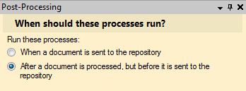

Due to the way Quick Fields processes documents one page at a time, it doesn't know how many pages your document will have until the Post-Processing stage. So to require that a process runs only on the last page regardless of how many pages there are, you'll need to do the following:
First, set Post-Processing to "After a document is processed, but before it is sent to the repository", like shown here:

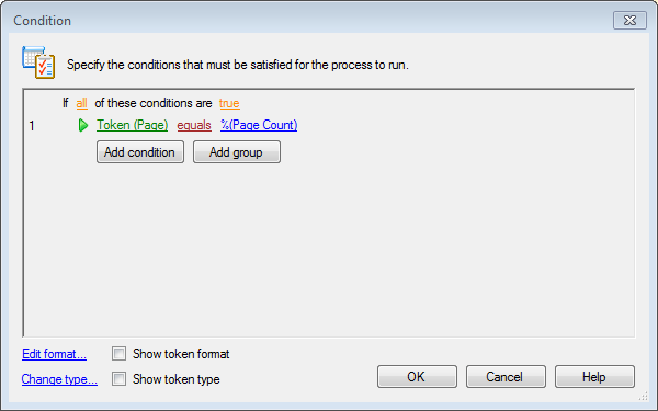

Then, in the Post-Processing section, create a Conditional process with a condition like this:
Now, any processes you add under this Conditional process will run only on the last page. You can use the tokens from these processes in the document's fields just like you would any other token.
