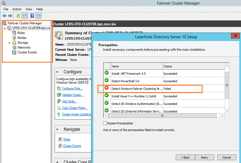

Hi People,
Installing the Laserfiche Directory Server with already installed windows Failover Cluster Feature through server Manager and nodes added.
It gives below error !!
Please need help.
Hi People,
Please need help.
Please try running setup.exe from the DirectoryServer folder instead of using the autorun and let us know if the prerequisite gets installed
There is an issue we are investigating with detection of Failover Cluster feature failing sometimes when the install is launched from the autorun (reference number: 149723).
Installing by running setup.exe directly should workaround the issue.
Hi All,
The case was opened and the same was guided.
The workaround works to install Directory Server by running setup from Directory Server folder.
Thanks for interests and assistance.

Yes tried with same , but the update for Windows Server 2012 !!
Error - Not Applicable to your computer.
Regards
Sufyan Khatib
Hi Sufyn,
please open a support case with support.laserfiche.com and attach the Operational trace event log (from Applications and Services Logs > Laserfiche > Directory Service > Server), Admin event log (from Applications and Services Logs > Laserfiche > Directory Service > Web Admin), the Application event log (from Windows Logs) and the System event log (from Windows Logs).
All 4 logs should be unfiltered and saved as .evtx files. If they are too large to attach to the case, please make sure to zip them up first.
