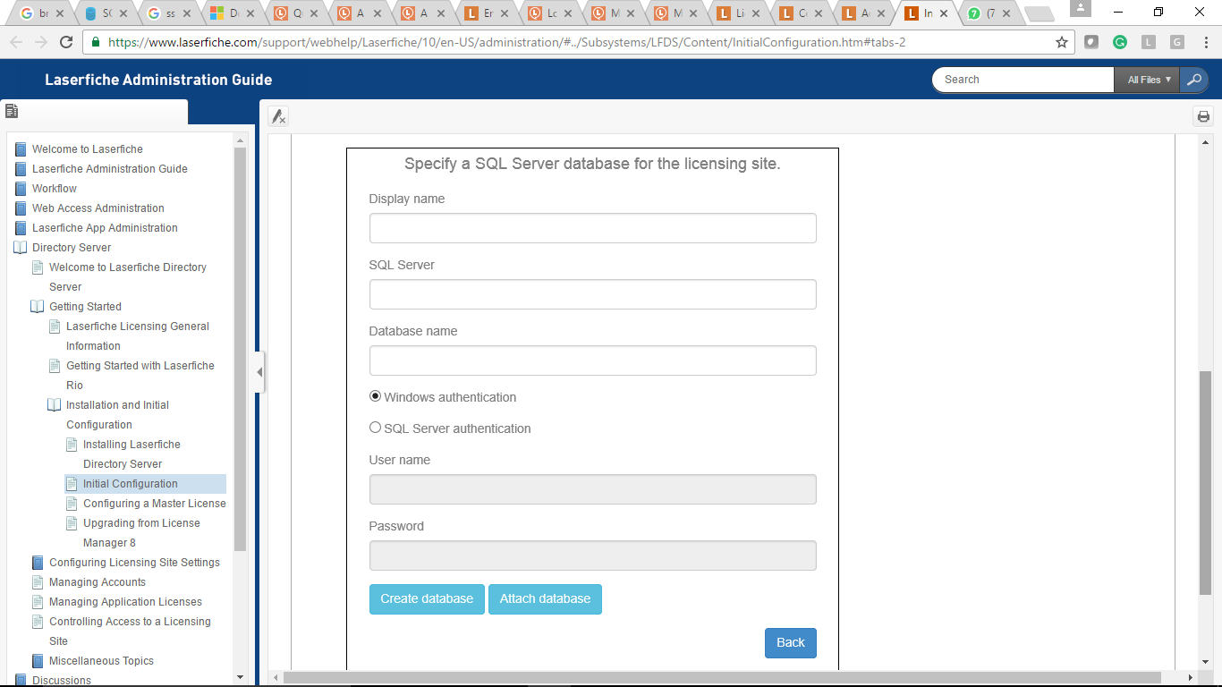

In below how can we attach database ? (Can't find an option as guided in Administration guide)

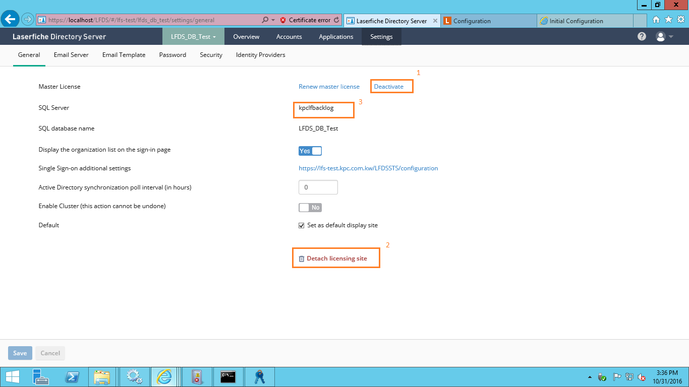

1. Deactivate. [On Old LFDS server]
2. Detach.    [On Old LFDS server]

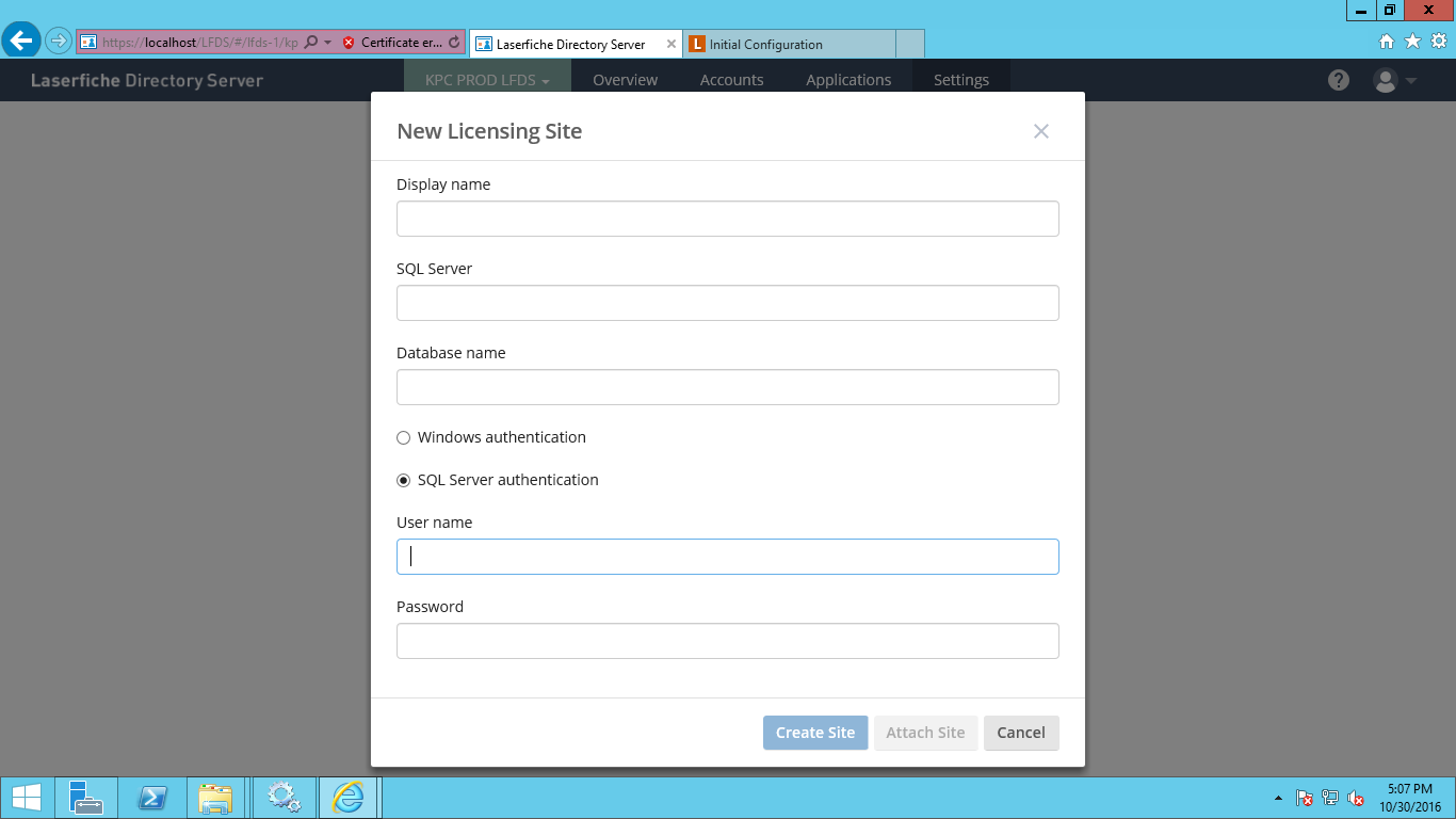

4. Use Same display name of old LFDS server (to avoid assigning license again) , new  SQL Server 2014 , restored database name [On New LFDS Server]

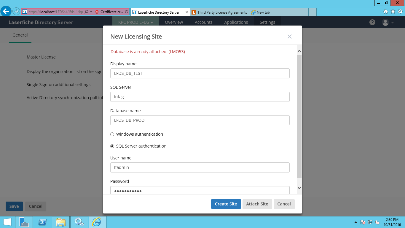

Got the error , as I wasn't sure how to detach database .
Hope above step no. 3 is Correct !! and proceed
