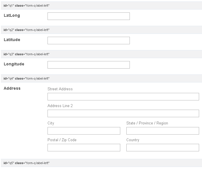

Is is possible to get a copy of the actual form?
replied on September 30, 2016
Laserfiche prohibits sending xml files. I have a blank copy that works great.
I will give you instructions to build it.
First create a new form. Second add three single line textboxes to your form. Name the first textbox LatLong. Name the second texbox Latitude. Name the third textbox Longitude. Next add the address control to the form. Make sure it is the fourth control you add. After you add the address control add the "Custom HTML" control to your form. Next click on the Custom HTML control and select edit. Under the Basic tab select the html button then add this HTML code. <canvas id="map-canvas" width="700" height="400"></canvas> Next click done. Then click on the "CSS and JavaScript" tab and enter the following code into the JavaScript section.

Save, Test and Enjoy
