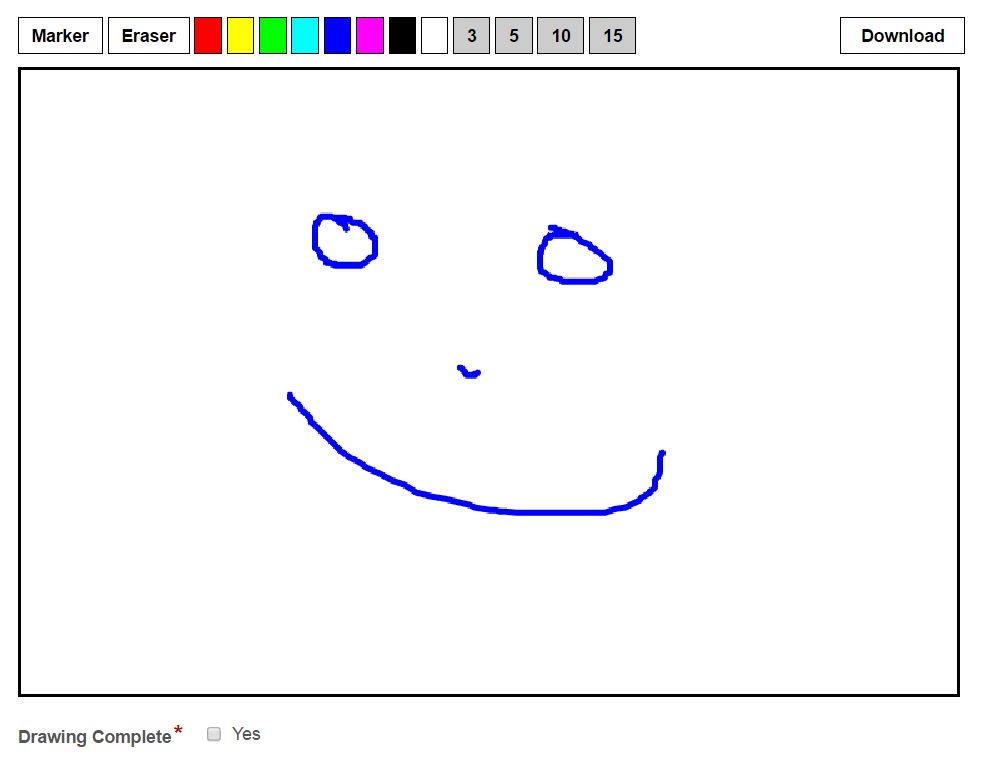

replied on May 4, 2017
Is there a way to do what Chris initially asked for other purposes "how to Hold or freeze an custom HTML active script when submitting"?
Although I am not drawing maps, I am free hand drawing using a color pallet. It looks great until you click submit, the drawing appears blank after submission.
I'm okay with adding an additional checkbox asking if it's complete so it can act as the trigger to "lock it down".
Thanks in advance.
