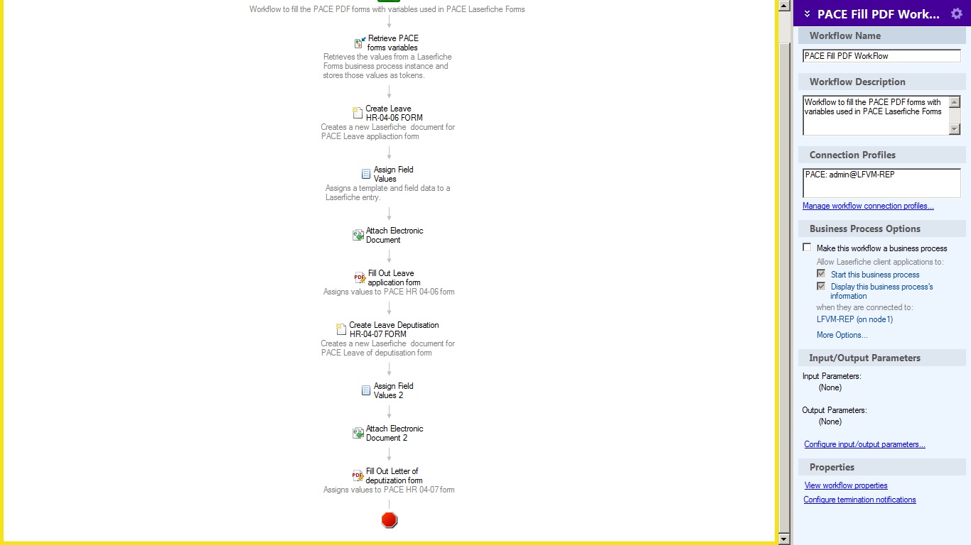

Hi all,
I have a workflow which gets started after a submission in Laserfiche forms.
So the function of workflow is to use the variables captured from the Laserfiche form then to fill out another PDF form and to store the filled PDF form into repository.
The activities I used on the workflow is described below.

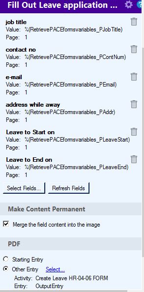

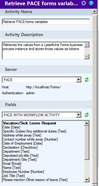

1) Retrieve business process variables(To get the form variables to be used in Workflow activity).

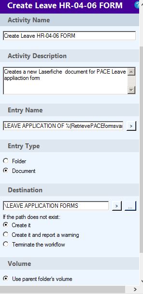

2)Create Entry. (To Create a Laserfiche entry   in a specific folder inside repository).
3) Fill out PDF form(To fill the desired PDF form, Have selected the master PDF form and have assigned the values of form variable to the fields in  PDF form)

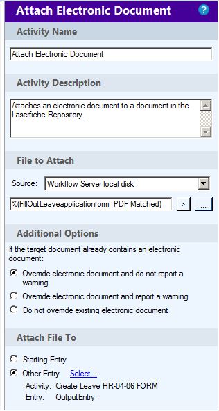

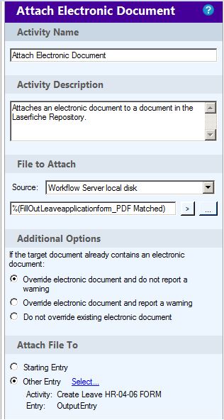

4)Attach electronic document(Attach the filled out PDF form to the entry created in step 1)
The workflow doesn't do the desired function. I think the problem is with the properties of Attach Electronic document activity mentioned in step 4.
How to attach or use the filled PDF token to be associated with create entry activity mentioned in step 1.
Please guide me where I am wrong , possible sample screenshots of working workflow much appreciated for current scenario.
Attaching screenshots of Workflow designer and also the properties of each activity.

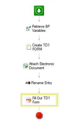

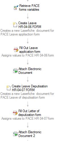

replied on September 19, 2016
I believe you need to attach the PDF to your document before you attempt to fill it out.  So you need to reverse the order of your "Attach Electronic Document" and Fill Out PDF" activities.
5 0
THANK YOU MIKE.
That was exactly what I required to change! smiley
Just rearranged the steps in workflow.
Also changed the "Source" of  ATTACH ELECTRONIC DOCUMENT activity to  "Server Attachment" and chose the PDF to be filled .
WORKS LIKE A CHARM NOW!!! blush
CHEERS MATE!yes
Best Regards
Akhil Paul.
replied on November 9, 2016
Akhil Paul, would you be able to post a snapshot view of the newly arranged workflow activities?
Thanks!
replied on November 22, 2016 • Show version history
@████████ Sorry for the late reply.
Please find the below snapshot view of the newly arranged workflow activities.
Do revert if you have any clarifications to be made.

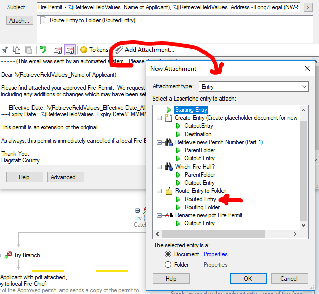

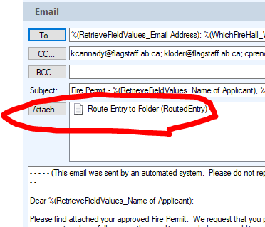

replied on July 12, 2019
There is an Email Activity that you fill out and add the attachment from whichever wf activity you built the pdf or an activity where you routed the pdf.
replied on July 15, 2019
Thank you, that worked!
