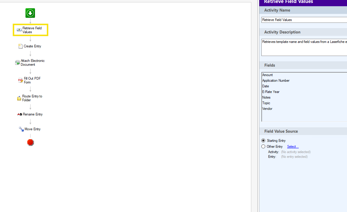

Retrieve Field Values from the Template I used in the form.  Selected the fields that I wanted to put in the Fillable PDF.

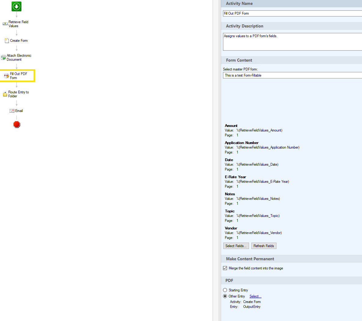

Attach Electronic Document I selected the PDF that I created that has the fillable fields on it.  I made sure to select Other Entry and Create Entry.
For the Fill Out PDF Form, I just selected the PDF again and matched the fields with the variables coming from the LF Form.

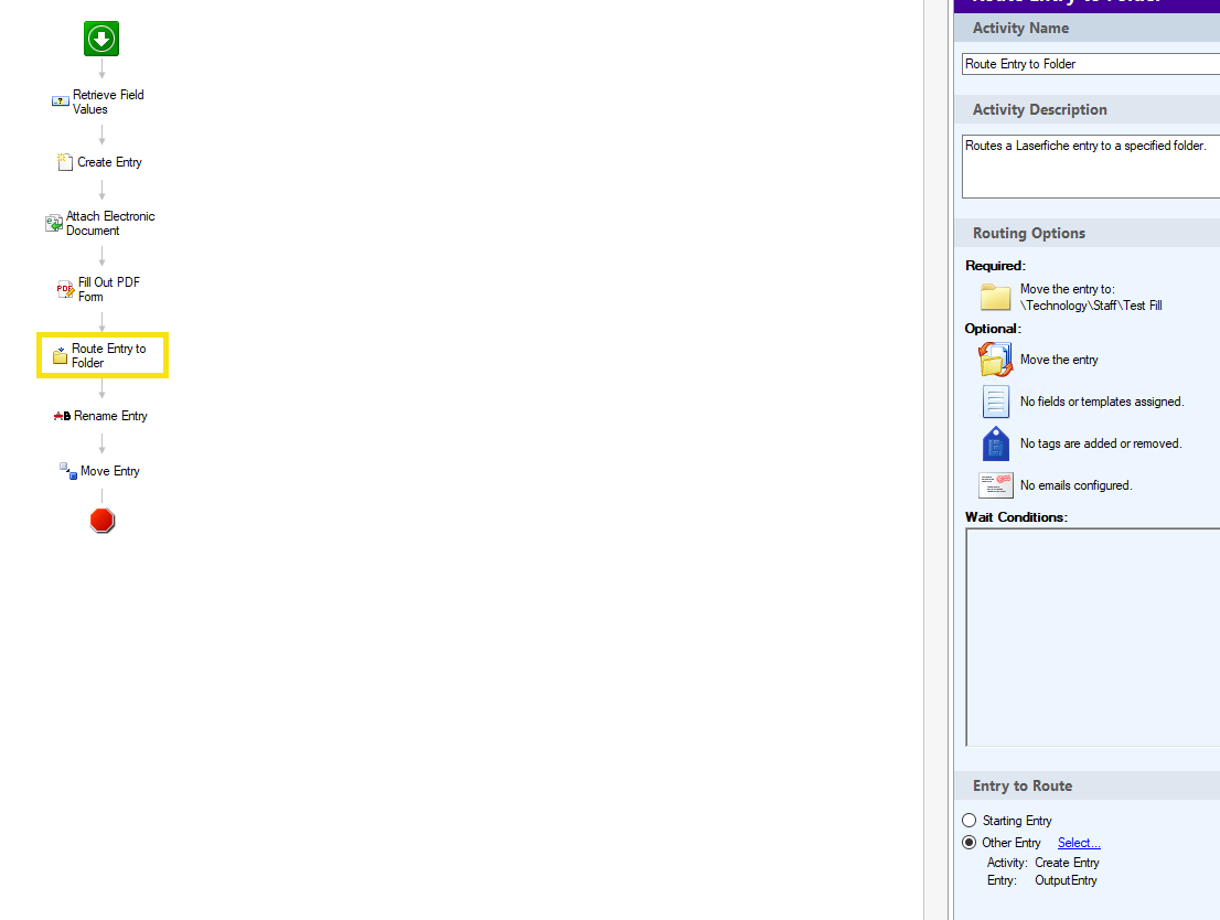

Routed the Entry to a desired Folder.
I threw in a Rename Entry so I can get the name right.  I can probably do this at the Create Entry and it would work.
Last, I used a Move Entry to move it where I want it.  Again, I can probably do this at the Create Entry but I will see what happens.
