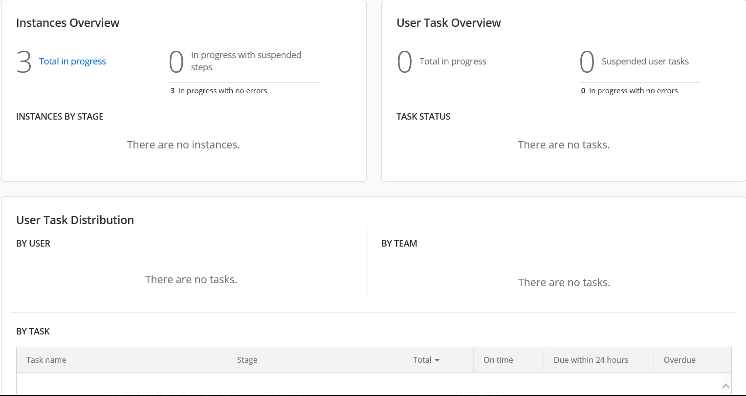

I modified both the production form and the production business process while I had three instances started with the old form and business process still In Progress.

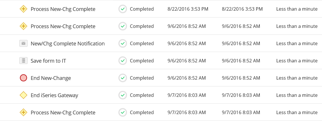

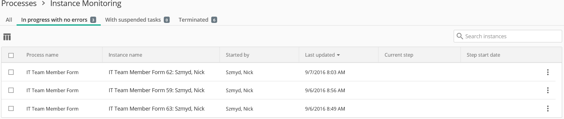

When I look at the three instances they show as In Progress but do not show any tasks open.  When I go into each instance, two show tasks completed up to a point with no End task while one shows up with and End task and then shows the task that was completed this morning.  All show as open.
Since these are still test versions, I have no problem terminating them to stop them running, but I need to know what is the best methodology when updating a form and business process at the same time you have production documents in process?  Please advise.  Thanks.

In Forms, running instances are binding to variables and steps. This means your process in production should be fine if form layout/name changed; however, if a step in process modeler gets deleted, it depends on whether your instance has hit that step or not. (The instance would be terminated if the step gets deleted while it has been triggered).
In terms of your question:
Two show tasks completed up to a point with no End task while one shows up with and End task and then shows the task that was completed this morning.  All show as open.
There’s also a chance that your instance hit a “terminated” status , if your process is not properly configured (for example: there's a gateway/task goes to no where)
Form your screen shot, I note that you have inclusive gate way and parallel gateway happened after it’s already hit the “end new change” event. I‘m wondering if you have other tasks still open (aka in-progress), in which case the process should still stay in-progress, as expected. If this is not the case, please open a support case so we can take a closer look at it.

Lifei,  When I changed my business process, I removed two exclusive gateways associated with those tasks. So that would be my 'gateway to no where' situation.  I should have been thinking about those three in process before making any changes to the existing business process.  Ming's answer helped me visualize what order in which changes need to be made.  Thank you both!
