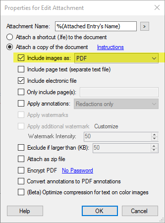

Is it possible that you are now saving image documents from Forms instead of PDFs? That might cause it since you are only sending out the electronic component.

I think that is it.  I just looked and I have a mixture of both PDF's and tiffs.  I'm going to test but, just checking the Include images as PDF's should fix the issue.  If this is it.
