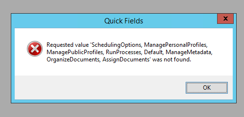

You mention "if their Quick Fields 8 or 9 sessions use process profile permissions."
Is the error presented like the following?
Requested value "SchedulingOptions, ManagePersonalProfiles....Was not found?
replied on July 15, 2016
Yep, that's it.

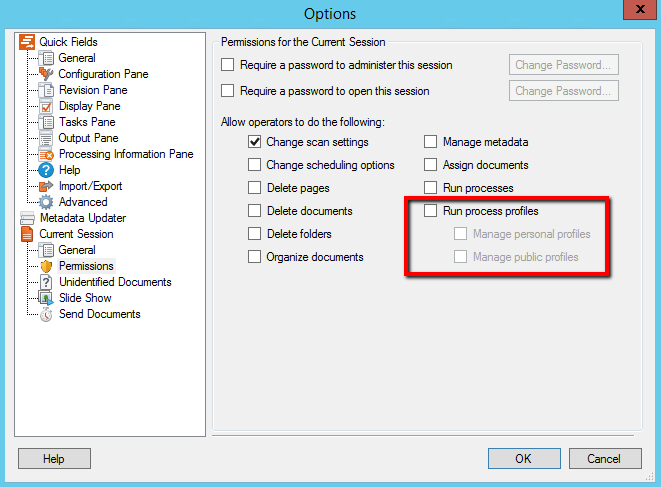

Until the update, the best solution is to open the session in Quick Fields 9 and go to Tools -> Options -> Current Session -> Permissions and make sure all the boxes under "Run process profiles" are unchecked.
After making those changes, the session should now open correctly in Quick Fields 10.
