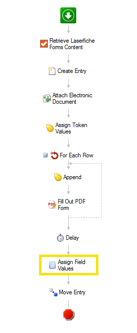

I'm in the process of setting up a PO Approval Process, and trying to get some input from other folks that may have done this before. Any and all input would be helpful!
The process starts in LF Forms; an employee fills out the form with all of the important information; Requester, Leadership information, Dates, cost codes, amounts, etc. The Form goes to leadership to proof-read the information. Once approved, it kicks off a workflow to fill the formal PDF form.
The WF looks like this:
The reason for the delay, is to give the WF a few moments to fill the PDF out, before assigning values. Without the delay, weird things happens. The Move Entry is to move it to another Repository.
The snag that I am running into is signatures; the PDF Form (the one that WF fills out) requires 3 signatures/stamps, one from the Requester, one of the approving leader and another from our procurement department. Since it's a PDF, and not an Electronic form, I can't use stamps or annotations.
I'm a bit stuck - suggestions?

I'm not really sure what you mean by "weird things happen" without the delay. The delay wouldn't even start until Fill PDF is done.
That said, why not do the review in Forms where you can collect signatures? The you can just let Forms save the final form to LF as a PDF.

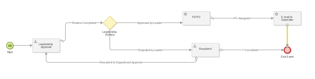

I would love to do the review while in forms. But from my understanding the only signature that Forms will collect is the first one, by the initiator.
replied on July 1, 2016
You can actually make separate forms for different user tasks throughout the approval process. On each form you create it can have a signature field where each person can then sign at each step of the approval process. This way you can collect as many signatures as necessary.
Okay - that's cool.
If I can get my 2nd domain to work correctly with forms I might take another look into that. If I can't get it to work, I'll probably be stepping away from using Forms and going back to SharePoint, which is depressing.
