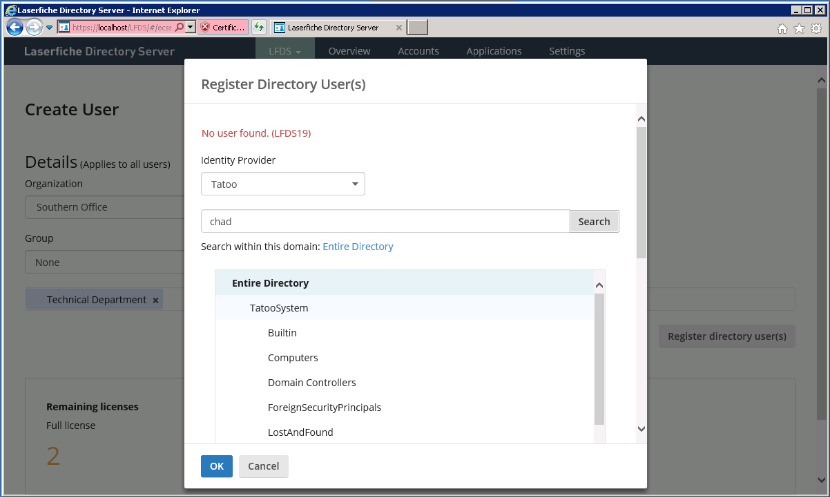

Miruna, we are testing this scenario (two domains, no domain trust) and are able to add the identity provider for the second domain using domain admin credentials.  We are even able to browse the directory of the secondary domain.  However, we receive a "No user found. (LFDS19)" message when we search for a user -- screenshot attached.  Other than opening ports 80,5051, and 5048, do you know if anything else needs to be opened up to make this work without the domain trust?

Hi, Chad!
We're currently looking into this issue. It looks to be a bug in the way the web admin console authenticates to the other domain.

replied on October 21, 2016
We are currently working on a patch that we think will address this issue, among others.
