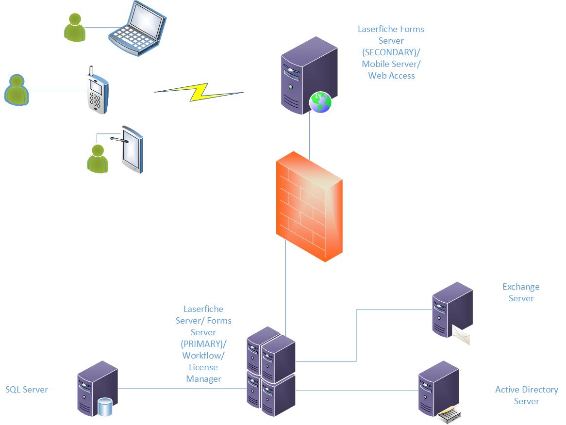

replied on September 10, 2015

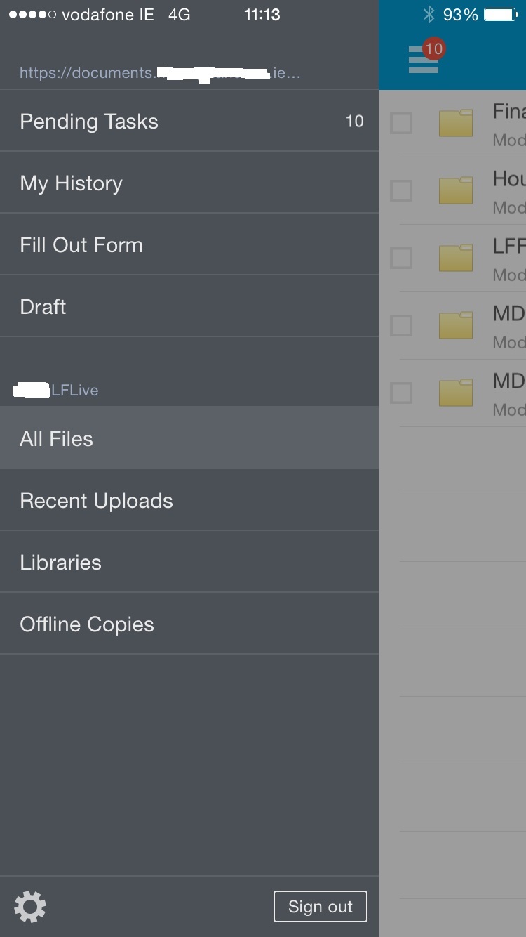

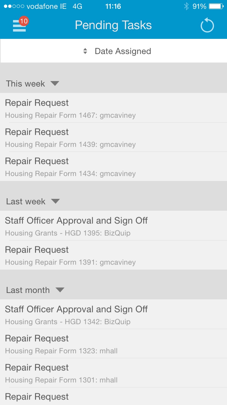

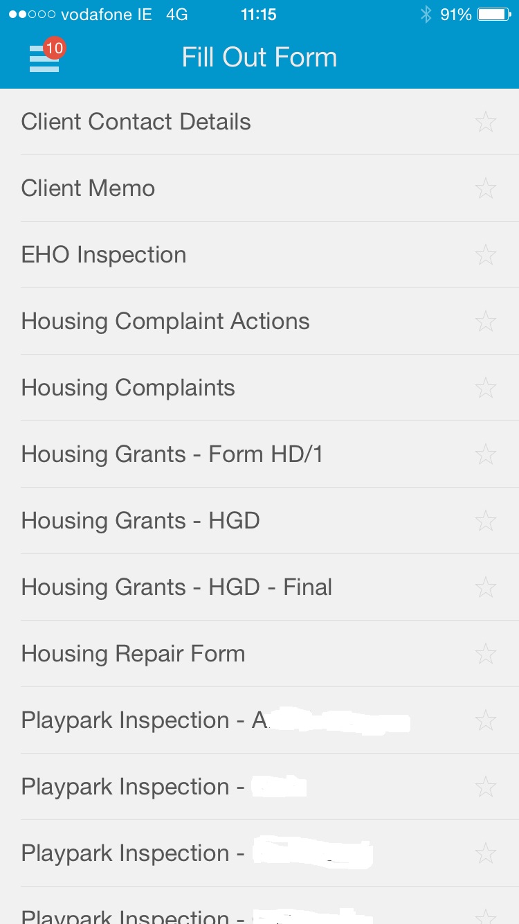

Attached is basis network diagram. Note two instances of Forms. External server's instance points to your primary instance inside the firewall.
Also attached some screens from my iPhone looking at a client site this morning across cellular network.
Hi Chris
Re the Mobile App. We have a client that access, participate and submit forms via the mobile app out in the field using cellular coverage only. Works perfect.
Only drawback is trying to launch a form from a url in an email which you can't do currently as it defaults to browser.
If going in on browser and they are an authorised user, the portal add-on is not necessary. Set up a web server (SSL) outside firewall with forms instance pointing to internal forms server.
It is my understanding that Forms Portal Add-On is purely for deploying forms function to a portal to allow for anon submissions.
I can remote you in to have a look at one of our sites if it helps?
Cheers Fearghal. Do you have a simple network diagram showing how this is setup?

Both Forms and Mobile have to be available externally in order for the mobile apps to be able to submit forms externally. The litmus test is, if the mobile browsers (Safari, Chrome) can access  Forms the apps can too, otherwise they cannot.
The Offline Forms feature is in the works, where forms made available for offline access will have their definitions stored on the device and can be filled and submitted while offline and synced with the Forms server once network access is available. No release date promise here.
As for the Forms server not being available externally – you would have to detail the concerns as depending on those the solutions differ.
You could set up 2 Forms servers, one in the DMZ and one behind the Firewall, both talking to the same database. See https://www.laserfiche.com/support/webhelp/laserficheforms/9.3/en-us/forms/#Administration/ConnectingMultipleFormsServersToTheDatabase.htm?Highlight=dmz
Another alternative would be setting up a reverse proxy (possibly on the same machine as the Mobile server) which would route all http traffic to the Forms server located behind the firewall (with the corresponding firewall rules to let it go through) and configure Mobile to use this reverse proxy server.
