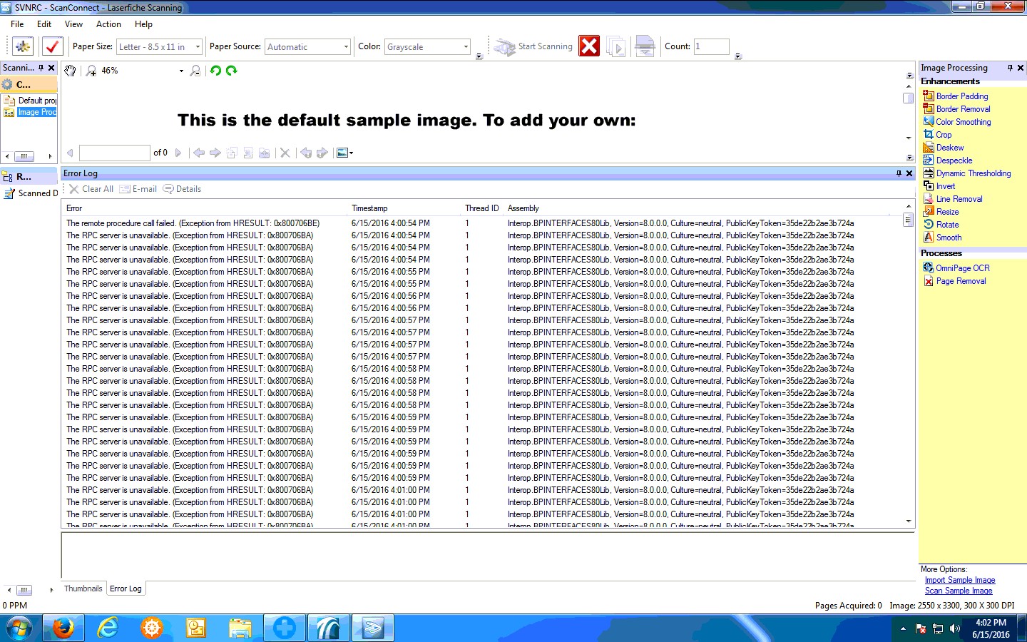

I have a client who recently updated an XP box to windows 7 and now scanconnect is acting up. this is for a Kodak i1320 scanner. ever since the switch it has seemed to not work at all. newest drivers are in place, it was checked outside of laserfiche with the scan validation tool and it works just fine. have tried to uninstall and reinstall scanconnect and drivers, ran a repair and still no luck.
this is the oddest part about the whole thing....it scans fine in black and white but once scanning is tried in grayscale (which is what they use) or color, it locks up and gives a windows "scanconnect stopped working" message. once that is closed out I checked the error logs and it just continually pulls down these RPC server is unavailable errors. You then have to Ctrl+alt+del to even get out of scanconnect.

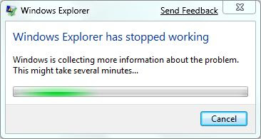

when it comes to the stopped working message: this is that default error you get anytime scanconnect starts to lock up. these are the same messages you see with other products that lockup, even non laserfiche ones, it's like that default windows error when things stop working properly.  this is how the scanconnect one looks, but it just says scanconnect has stopped working. I just pulled this off line quick so you know what type of message I'm referring to. normally you get some feedback on these but this one just seems to not do anything.

the errors I'm referring to there are the ones in the first screenshot. if you look I have pulled up the error logs in scanconnect. these errors are what starts to pop up after scanconnect locks up after trying to scan in grayscale. they say that the RPC server is unavailable. I tried to do some searching on the error and nothing is glaring as to the issue. they seems to be endless and the list just continues to populate until you close scanconnect. which, again, you need to ctrl+alt+del to even get out of it.
