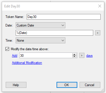

I am working on a workflow that sends out reminder emails that contracts are expiring soon.  So, if a contract expires on 10/1/2016 and NotficationDays is set to 90, the initial email reminder will go out on 7/1/2016.  This date is calculated using Expiration Date minus NotficationDays = 10/1/2016 - 90 days.  A 2nd email reminder is sent on 8/1/2016 (30 days after the initial reminder).  This is calculated using the following formula = Expiration Date minus NotficationDays + 30 days (10/1/2016 - 90 days + 30 days).  I have all of this working.
Where I need assistance is on how to generalize the formula. Depending on how much work is involved in renewing the contract NotficationDays for a particular contract could be set to 360, 180, 120, 90, 60, or 30 days.  I want an initial email to be sent on NotficationDays prior to the contract expiring and then every 30 days following that date, until the contract has expired or the expiration date has been update and this condition for sending email reminders is no longer valid.
Any assistance is greatly appreciated.  Please let me know if something is not clear.
Thank you.
replied on June 15, 2016

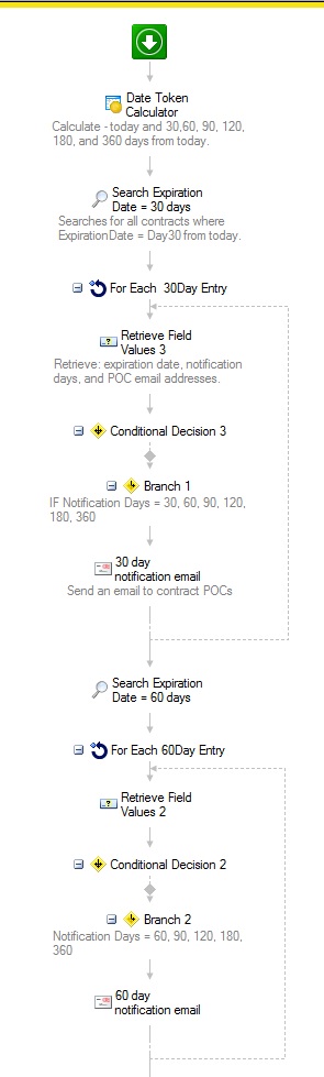

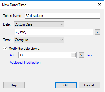

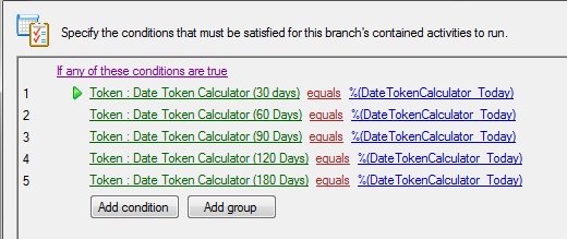

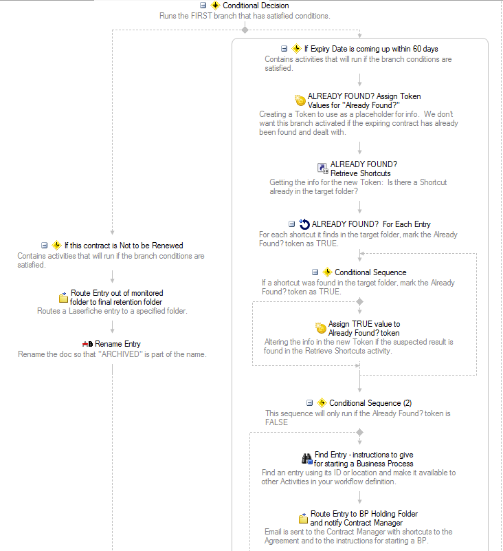

We use the Date Token Calculator to check the Expiry Date before notifications.
Then we use some conditional decisions for it to decide what to do with any of those it finds that meet the criteria.
replied on June 16, 2016
Connie,
Thanks for sharing.  I like the way you handle non renewed contracts.  I hadn't focused on that area yet.    I have used the Date/Time tokens in the past.  The question I have is, do I have to set up an additional date/time token if I want to send email notifications at 60 days and then again at 30 days?  If the initial email notification goes at 90 days, then I want subsequent email notifications at 60 and 30.

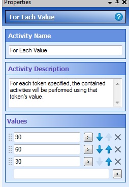

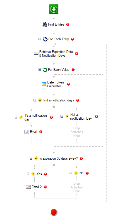

Greetings Barb,
Are you storing the notification days as a number in multi-value field?
You could add in a For Each Value loop which takes the value in the Notification Day, runs it through a Date Token Calculator based on the Expiration Date, and then perform a conditional activity.
It would look like this:
Let me know if you would like further detail.
Carl, this workflow will end up processing the same documents over and over even when no notifications need to be sent out. Depending on the size of the document set and how many expire each day, this can get really slow and inefficient. Searching for the documents that need to send emails each day like Connie suggested is more efficient.

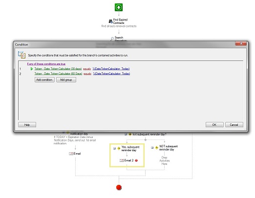

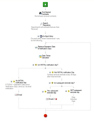

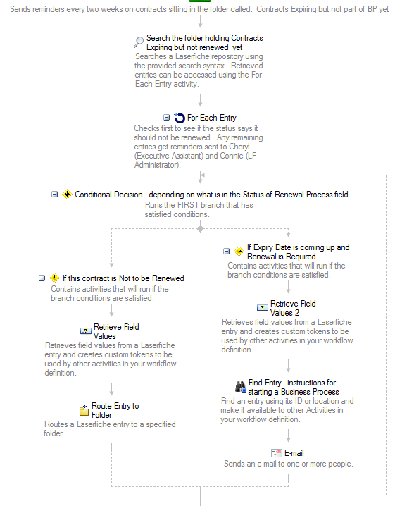

I have reworked my workflow.
My subsequent email reminders at 30, 60, etc days after the initial reminder will be directed through here:

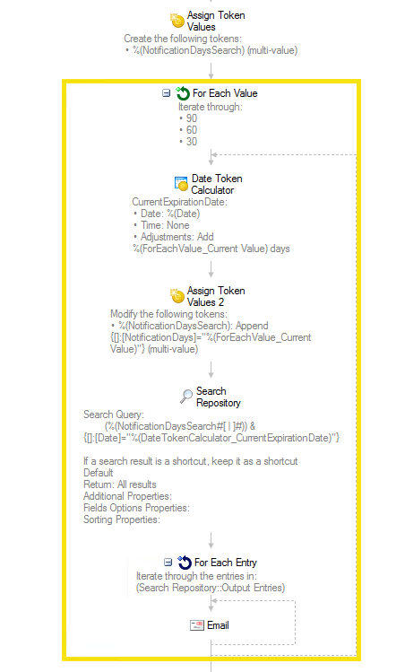

So I'm going iterate over all possible values for how far ahead you want to send notifications: 30, 60, 90. Then for each one of them I'm going to calculate the date I need to run the search.
Where it gets slightly complicated, it's the search for the NotificationDays field. For 90, it would be easy, it's {[]:[NotificationDays] = "90"} . For 60, I'd have two criteria: {[]:[NotificationDays] = "90"} | {[]:[NotificationDays] = "60"}. And for 30, we'd have 3. So I'm going to iterate through the values in reverse order so I can append to the search criteria as we go.
To do that I'm going to use a multi-value token and append the entire search criterion at each pass using {[]:[NotificationDays]="%(ForEachValue_Current Value)"}
That will give me just one value for 90, 2 for 60 and 3 for 30. Then we can flatten them out into an "or" search by indexing the token in Search Repository with "|", which happens to be the "or" operator in the Laserfiche advanced search syntax.
You can set Search Repository to retrieve any fields you might need in the email along with the documents.

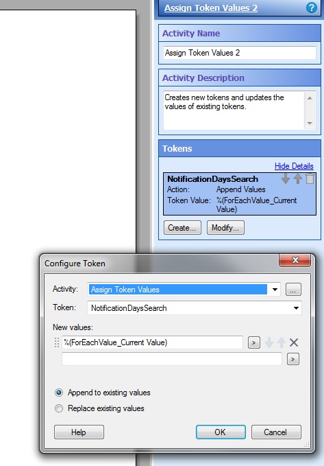

replied on June 20, 2016
The section labeled "Assign Token Values 2" is confusing.
If I use "90" as the value for the 1st iteration of the For Loop.  The date token calculator assigns 90 days to today (6/20/2016).  So current expiration date equals 9/20/2016.
In my example of using "90" as NotificationDays search,  what happens in the "Assign Token Values 2" area?
Thank you for the assistance.
That one is building the search. So for the first iteration, with "90", it will end up as {[]:[NotificationDays]="90"}, which we need in the search.
What is being appended?   Doesn't NotificationDaysSearch already the values of 90, 60, 30 assigned from the Assign Token Values at the beginning of the work flow?  I feel like I'm missing something here.
No, the token starts out blank. You can't start out with the token fully populated with all 3 values because your search results would be wrong.  A search for NotificationDays in (90,60,30) and Expiration Date 9/15/2016 might bring up a document with NotificationDays = 60. In that case, you'd be emailing a month too early.
So the search has to be built as we go. For 90, we need just NotificationDays = 90, fo 60, we need both 90 and 60, for 30, we need 90, 60, and 30. That's why I'm going through the values in reverse order: each iteration adds another search criterion.
(Side note: 90 days from 6/20/2016 is 9/18/2016. If the day is supposed to stay the same, we'd need to add 3 months instead of 90 days.)

No worries. You want to append the whole search criterion for the field search for the NotificationDays field:
replied on June 22, 2016

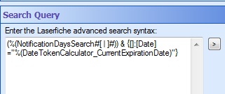

Here is my search:
Could you explain how this logic works?  I had to insert spaces into #[ | ]# or Laserfiche returned an error.
Thank you.
What is the best way to limit which folders are searched? I don't need the whole laserfiche database searched.  I have typically started my workflows with a "Find Entries" pointed to the folder I wish to search.
Sure.
So on the first iteration ("90"), NotificationDaysSearch token has one value:  {[]:[NotificationDays]="90"}. Current expiration date is today + 90 days, so 9/20/2016. At this point we're searching for {[]:[NotificationDays]="90"} & {[]:[Date] = "9/20/2016"}. Which gives us the documents that will expire in 90 days and need the first email sent.
On the second iteration ("60"), NotificationDaysSearch token still has the first value {[]:[NotificationDays]="90"} and gets a second value appended to it: {[]:[NotificationDays]="60"}. Current expiration date is today + 60 days, so 8/21/2016. Formatting the NotificationDaysSearch token with " | " gives us {[]:[NotificationDays]="90"} | {[]:[NotificationDays]="60"}, so our search becomes ({[]:[NotificationDays]="90"} | {[]:[NotificationDays]="60"}) & {[]:[Date] = "8/21/2016"}. This gives us documents that expire in 60 days and are either on their first email (for 60) or on their second notification (for 90).
Same way, for 30, we get a third criterion for the search, so we end up with documents that expire in 30 days and are on their first notification (NotificationDays = 30), on their second (60) or their third (90).
You can add a {LF:Lookin="path"} to narrow down to a specific part of the repository.

Ok.  The search keeps returning 0, when I use this structure:
{%(NotificationDaysSearch#[ | ]#)} & {[]:[Date]="%(DateTokenCalculator_CurrentExpirationDate)"}
So, I attempted to recreate the search directly in Laserfiche to see if I was missing something.  If I use the following search, I get the appropriate records returned, however I can't find a way to say Notification Days = 90 OR 60.   If I insert | then it tells back and tells me undefined character.
{[Contracts]:[Department]="Town Clerk", [Notification Days]="90"} & {[Contracts]:[ExpirationDate]>="08/13/2016", <="10/01/2016"} & {LF:LOOKIN="TownOfBrighton\Town Clerk\Contracts"}
I figured if I could get the search to work with hard coded values, then I could go back to re inserting the variables.
"|" is used to represent "OR" in between search criteria, not in between values. So it would have to be ({[]:[NotificationDays]="90"} | {[]:[NotificationDays]="60"}). Or, since you seem to be using the "Contracts" template, ({[Contracts]:[NotificationDays]="90"} | {[Contracts]:[NotificationDays]="60"}). The parentheses are there so the other criteria are considered together with the results of this OR search.

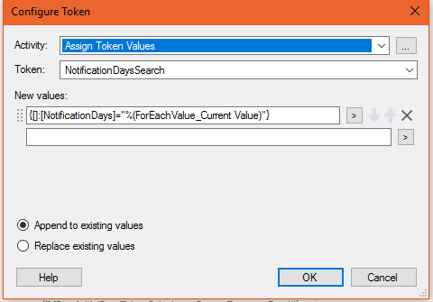

Update:  I found I needed to change the syntax in my email to get all the values to display.  Are these values correct?  Each value starts and ends with { }.
NotificationDaysSearch = {[]:[NotificationDays]="90"}
{[]:[NotificationDays]="30"}
Further Update: I modified NotificationDaysSearch to Append Values; Token Value of  %(ForEachValue_Current Value)
I now have the values of 90, 60, 30 being stored correctly.

replied on June 17, 2016
Okay, so, our reminders are handled on a separate WF.  The first workflow sends the initial notification and also moves the contract into a holding folder.  The second workflow monitors the contracts in the holding folder(s) and sends reminders once a month on a never ending loop, until someone changes the contract status to something that will make it stop (like "renewed" or "renewal denied").
