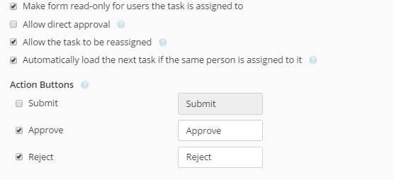

next task if the same person is assigned to it
asked on June 9, 2016
Hi,
I facing some challenge in form approval.
Scenarios: Claim Approval
User 1 --> User 2 --> User 3 --> Manager
User 1 will send a claim request  which will go thru 2 user before it reached the final approver.
The normal flow is working perfectly. All user will be able to make a claim. So logically, if user 1 make a claim, it should route to user 2 directly for approval. But i'm facing problem, as it still route to user 1 for approval.
The screenshot below, is the setting i did for user task for user 1
Really appreciate if anyone can assist me regarding to this.

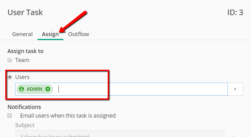

replied on June 10, 2016
Hi Jason. For the second approval that is meant to go to user 2, make sure that the user assigned is not User 1:
If you are using Teams, it will need to be configured correctly using filters and roles so that the task is not also being assigned to User 1 (if it is part of that team). More information about Teams in Forms can be found here.

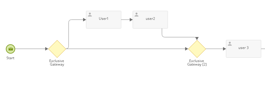

replied on June 12, 2016
Hi Jason, you can add a exclusive gateway after step of first submission to only route to user 1 when the first submission is not submitted by user 2.
The path condition can be something like "/dataset/_initiator!="user2""
