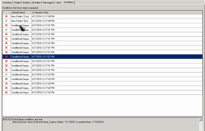

Can you add a screenshot of how the condition was evaluated at run time (from the Conditions tab in the instance details)?
replied on June 8, 2016
As you can see here the condition is evaluating incorrectly.
[False] If all these conditions are true:
              [False] Entry Token (ForEachValue_Current Value) '2/2/2015 (is greater than) '7/18/2014'

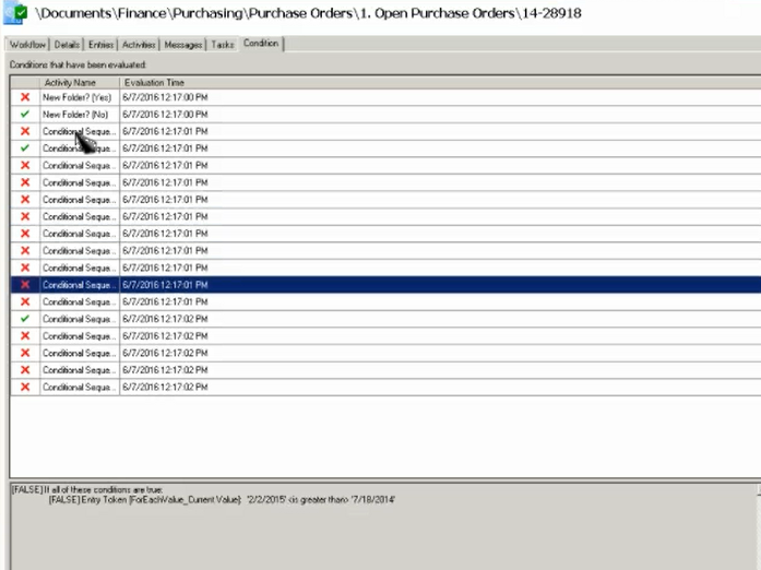

replied on June 8, 2016 Show version history
This one evaluated incorrectly

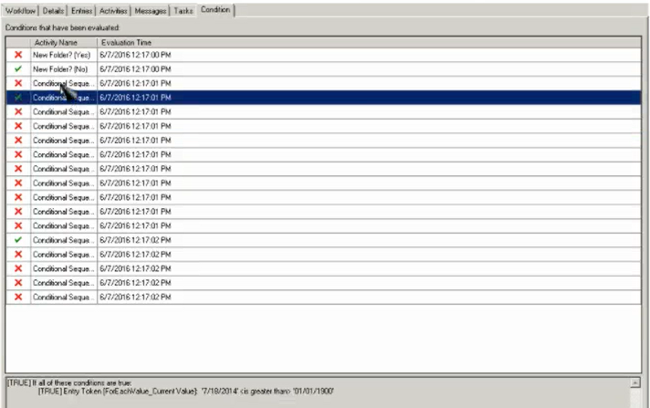

This one did evaluate correctly. The token starts at 01/01/1900

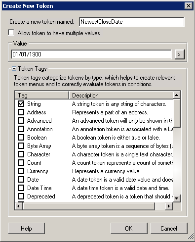

Looks like they're evaluating as strings. Did you start a new instance after changing the token type to date or did you just use the running one? Token types won't update after the token has been generated.
Yes. I republished and created a new test document which triggers the workflow. Im thinking I may need to remove the tokens and add them back into the workflow to refresh it. Will update here.

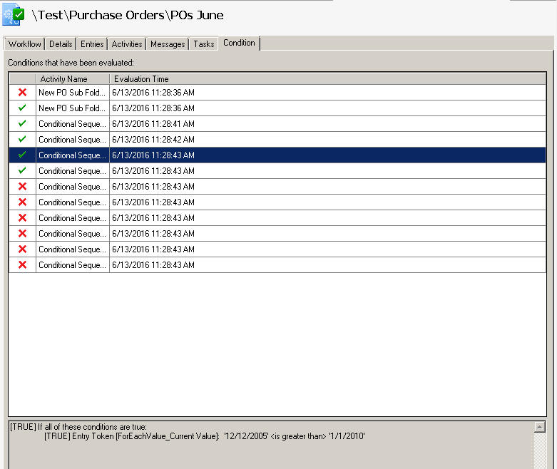

replied on June 13, 2016
I removed all the tokens and saved then added them back in but that still didnt work. I also recreated the workflow and the tokens are still not evaluating correctly.

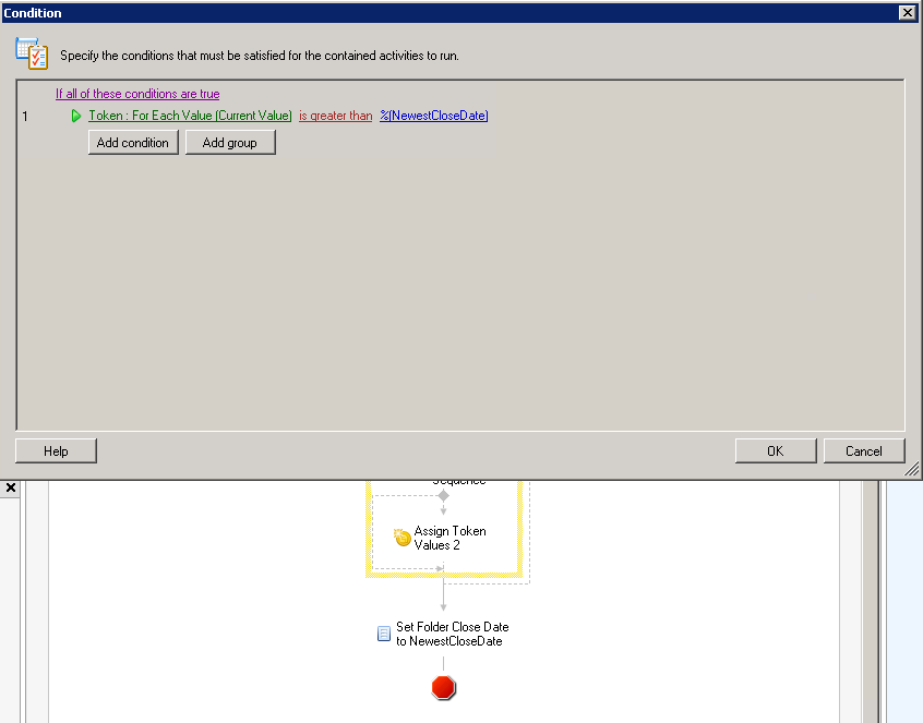

replied on June 13, 2016 Show version history
Where do the values in For Each Value come from?
For Each Value always sets its tokens as string, so the entire conditions evaluates as string. You can use an Assign Tokens inside For Each Value to set them as dates, and then use the newly created token in the condition instead of For Each Value's current value.
