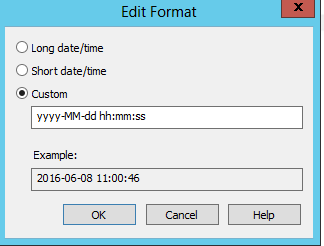

i need to have my date in this format yyyy-MM-dd hh:mm:ss
however, when selecting custom format as below
when selecting the date in the preview, i'm getting this result below
i want the date also the hh:mm:ss, however, it will give me only 12:00:00 AM for all records
can anyone help me out

When you click away from the field, does it reformat? I didn't have any problems getting my field to show the format i want (I used yyyy-MM-dd H:mm:ss for 24 hour clock):
When you select a date from the calendar picker, it will automatically assign 12AM as no time can be specified from the calendar. Did you know you can populate the current datetime in the field by highlighting the field and hitting the space bar?

As the calendar button only allows you to select a date, it will populate the date and time will default to midnight, but it should still be reformatted with no problems:
