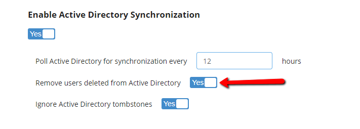

As of 10.3.1, there is an option under the settings page to change the behavior for deleted users:
When this setting is "Yes", users deleted in active directory will be removed from LFDS on the next sync.

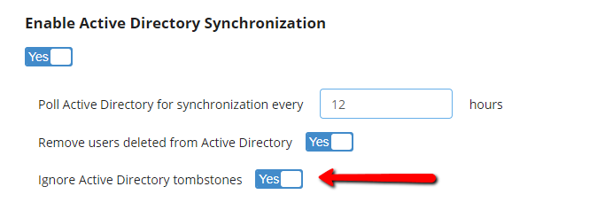

A note about the setting below that:
This controls whether or not users in the AD Tombstone (sort of like the AD recycle bin) are counted as "deleted" for the purposes of removing users from LFDS.
  • When the tombstone setting is off, user deletion in LFDS is delayed by the AD tombstone lifetime (60 or 180 days by default).
  • When the tombstone setting is on, users deleted in AD are deleted in LFDS the next time sync occurs.
Finally, note that this setting only applies to deleting users in LFDS --- this means that licenses are freed up upon user deletion in AD regardless of whether you want take the cautionary step of waiting for the user to be fully deleted from AD.
