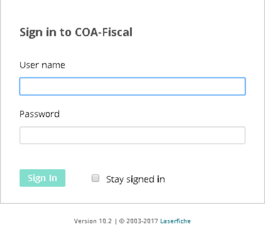

Hi everybody,
Could you please tell me where I can find the checkbox for windows authentication on web access?
Please see my configuration as shown below:

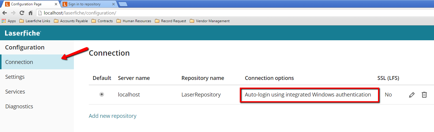

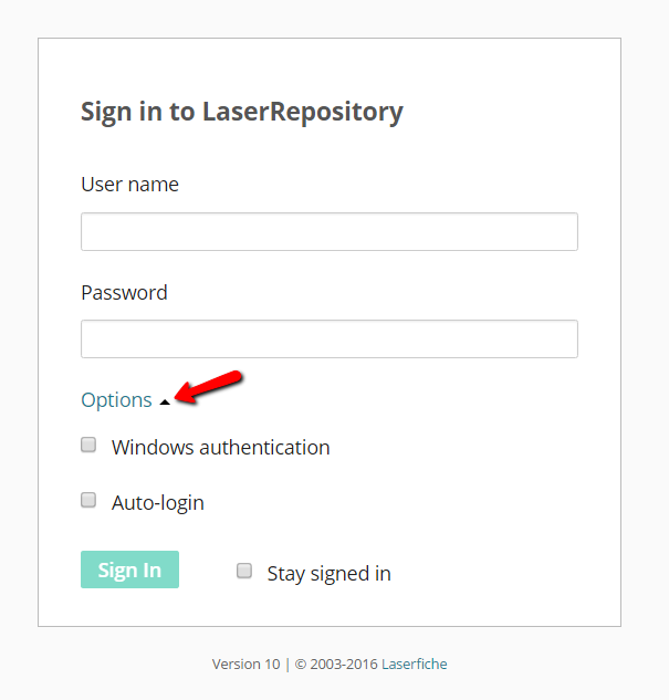

As Steve mentioned, Web Access 10.1 will have the Windows Authentication option easily available to you. Please install Web Access 10.1 before proceeding with the next steps.
Once Web Access 10.1 is installed, you need to make sure that your Web Access is configured properly. In the Web Access configuration page [default link is http://machinename/laserfiche/configuration/], under Connections, please make sure your repository is setup to use "Auto-login using integrated Windows authentication":
Once you have done that, you should now be able to see Options available from the Web Access login page, expand the options and you should be able to see the Windows Authentication checkbox:

If you scroll over to the right on the Configuration page you should be able to edit your repository and change "Prompt for Laserfiche credentials" to "Auto-login using integrated Windows authentication" or "Prompt for Windows domain credentials".

replied on June 9, 2016
Hi Ketsia,

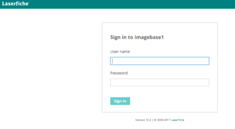

replied on July 7, 2017 • Show version history

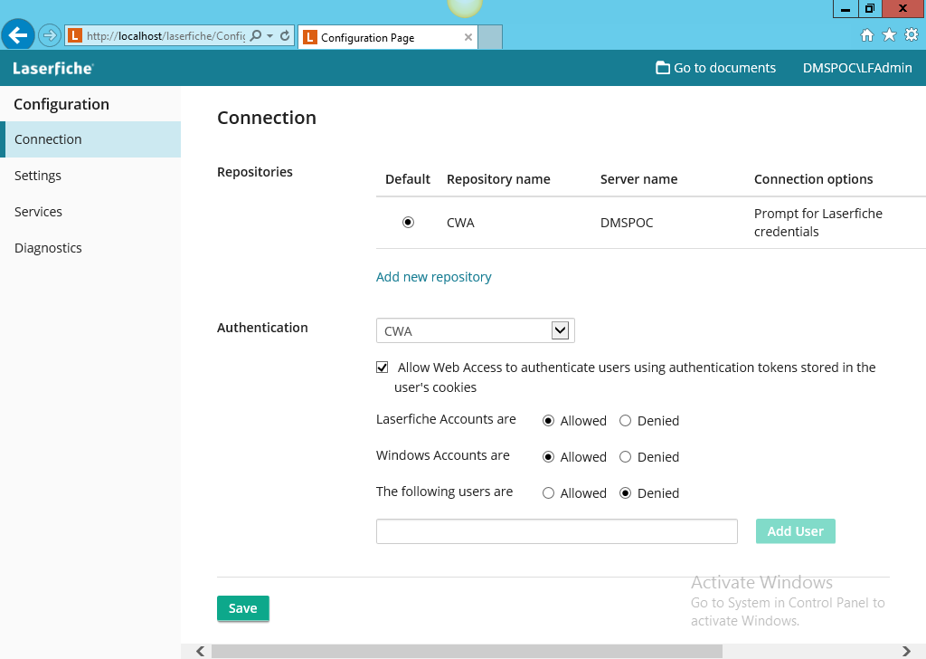

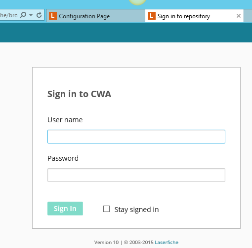

I am trying to set this up and have the configuration shown below.
However I do not get the "option" to use Windows authentication. I have refreshed the login page with no success. How do I resolve this issue.
replied on September 7, 2017
I installed laserfiche web access 10.2 and try all the connection option choice
and did not see the option that allow me to check the box Windows authentication to let a authenticate Windows user to omit to fill the credential again

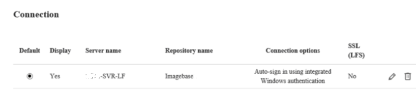

Auto-sign in is not working for our client and all options appear to be set correctly, help us please. We are using version 10.2.1 It works with the windows client just not with web access.
