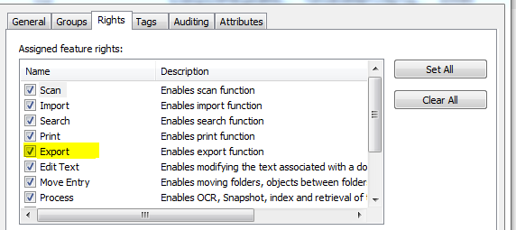

I am told by our reseller that there is supposed to be a pdf icon at the top of the page in the DocView results near the Go button, but my page does not seem to have that mechanism.  The best procedure I've been able to come up with is to put the document in full-page view and then print from the browser's file menu.  Looking for something more straight-forward if it exists.  I am using WebLink 9.0.1.275.
replied on June 6, 2016
the user needs to have the EXPORT rights in the admin console for the PDF/Print button to show up.
replied on June 7, 2016
Great, thanks again, Tommy!  I had given "print" rights to the user, but not "export" rights.  Easy fix.
