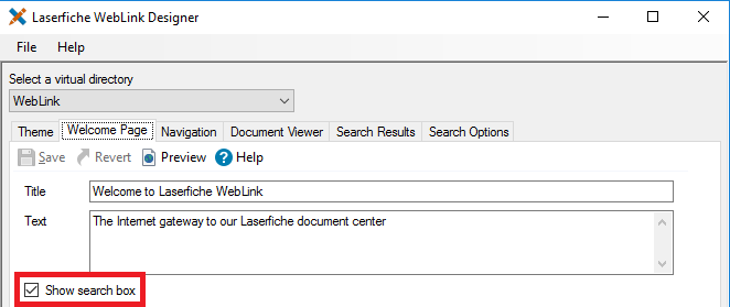

This is the option Tommy is referring to:
In the WebLink Designer, under the "Welcome Page" tab, uncheck the "Show search box" option.

Thank you, Tommy.  I had familiarized myself with WebLink designer, but was finding several limitations, so I started digging in under the hood.  I completely overlooked this simple little check-box.  Embarrassingly simple.  Thanks again.
