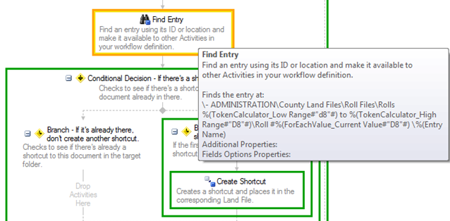

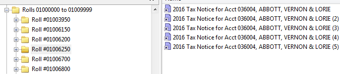

I have a workflow that is to create a shortcut in a Roll Number folder if a roll number is entered in the Roll Number field.  There is a conditional activity to tell it NOT to create the shortcut if there is one already there.  This is not working.  Could you help me troubleshoot?  (Note:  I believe the path in the programming is correct, because it's placing the shortcuts in the right folder and it's the same path that is used in the programming where I'm telling it to look for any shortcuts already there.)
Target folder results:
What the WF was looking for:

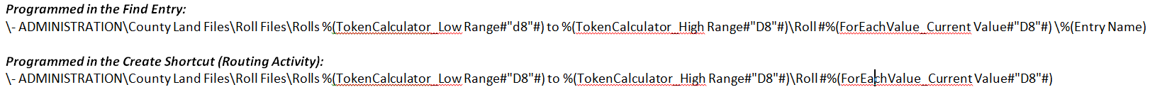

How it was programmed to find that entry name:

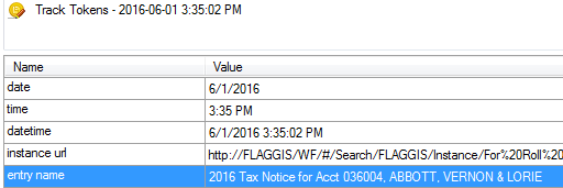

Thx, Connie Prendergast, Flagstaff County, AB  Canada

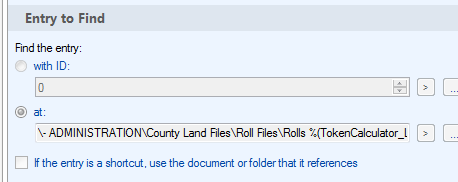

So, still have the problem of it not finding the entry, even though one is clearly there.  I keep thinking it's because it's a shortcut, but the activity ... oh!  Okay maybe it's BECAUSE I have not checked off the "If entry is a shortcut, use the document or folder that it references".  I keep thinking I don't want it to find an entry, I want it looking for a shortcut so I did not put a check mark in here.  Will try this next.

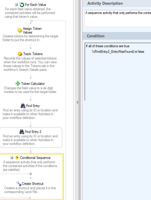

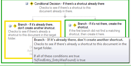

Ok, I found a way.  You use a find entry for the entry itself at the location, then a sequence activity to check if the entry was found before using a move entry.  Here is the diagram:

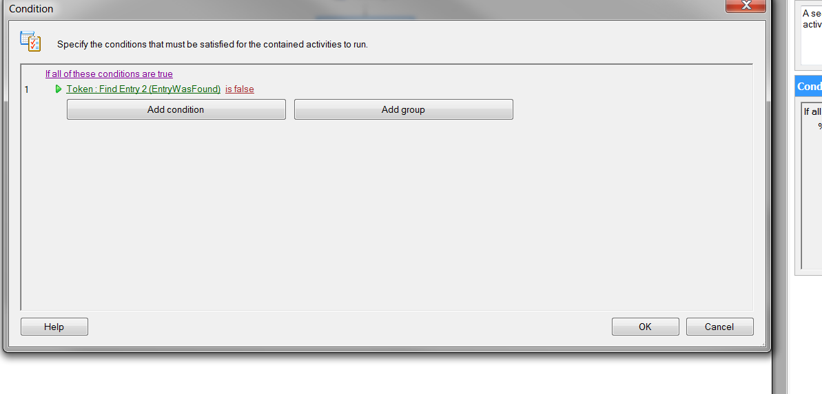

Here is the condition you set in the sequence activity:

The find entry activity right before it for you would be set to look at the same location you're already using, you just need to wrap the route entry or move entry INSIDE the sequence activity.  I've tried this, and it is working.  This way the condition is checked beforehand.

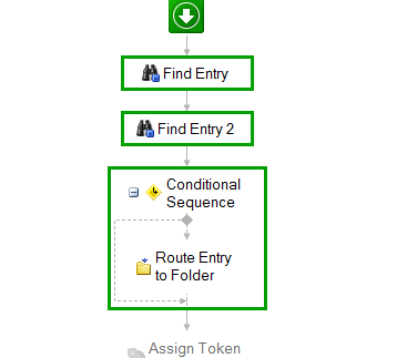

Rick, I'm looking at your Find Entry sequence.  I'm already using a find entry before the Route activity and I don't understand what the second Find Entry (2) is doing.  Here's what my WF looks like now and still getting duplicate shortcuts:

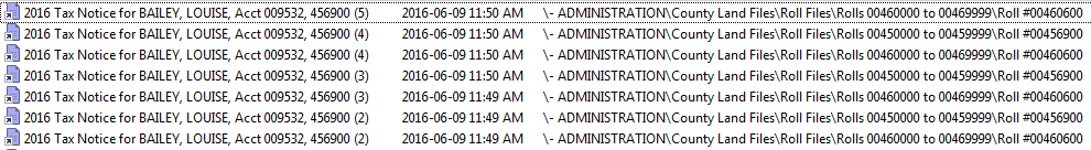

Okay, so I've been playing with the Wait Conditions within the Route to Folder and here's what I'm getting:
The first thing I noticed was that it now only creates a shortcut on the one new roll number added.  Previously, it was creating a shortcut for each roll number (multi-value field) but changing to this Routing to Folder activity seems to have stopped that part, which is good.  But it still created the one shortcut even though there was one there already.  And now all three test runs are ...waiting...

Find Entry Address:  \- ADMINISTRATION\County Land Files\Roll Files\Rolls %(TokenCalculator_Low Range#"d8"#) to %(TokenCalculator_High Range#"D8"#)\Roll #%(ForEachValue_Current Value#"D8"#)\%(Entry Name)
Route Entry Address:  \- ADMINISTRATION\County Land Files\Roll Files\Rolls %(TokenCalculator_Low Range#"D8"#) to %(TokenCalculator_High Range#"D8"#)\Roll #%(ForEachValue_Current Value#"D8"#)
