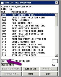

This may be hard to explain but I'm looking for any alternative solutions.  We have a client that plans on taking a few thousand of these screengrabs (see attached) and OCRing them to better search by serial, description, etc.  For simplicity's sake, the highlighted "ARM-CLUTCH PEDAL" will be OCR'd and everything is good so far.  The problem comes in when we take the second screen grab. The second screen grab will look almost the same as the first but the picture will be different and the highlighted item, which would now be "CROSS SHAFT-CLUTCH CONT" now needs to be OCR'd instead.  Is there any way that quick fields can pick up what area is highlighted to OCR that section?  Let me know if you need any other clarity.

Does the number at the bottom always match the highlighted rows?
replied on June 2, 2016

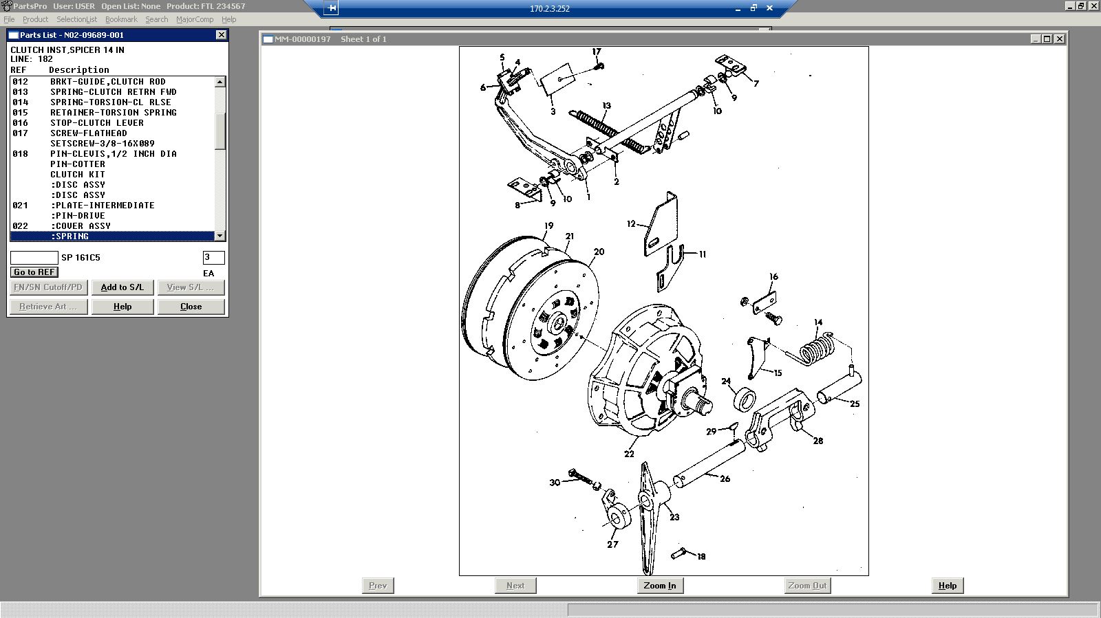

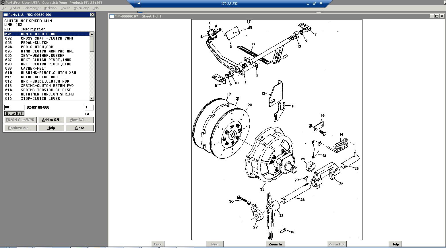

Yes. However there are some lines that coincide with the above number. (see another attached example.)
