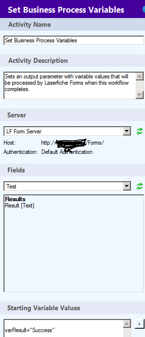

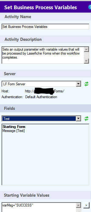

I'm not really sure what you're asking for. Set Business Process Variables uses tokens to assign values to variables in your Forms process. The one non-obvious thing is that the Service Task in Forms has to be set to wait for Workflow to complete.

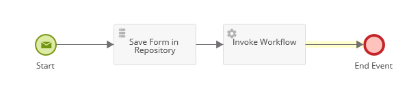

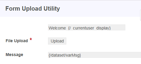

Below is screen shots of Workflow and the form that is calling it.
In "Invoke Workflow" activity "Wait for the workflow to finish before proceeding?" is set to Yes.
The form is redirected back to same form after upload ie there is no Thank You form.
I need to show the message returned by the workflow in the form shown below in design
Thanks for your help
replied on June 3, 2016
Workflow cannot run before the form is submitted. In your process, you only have the starting form, while the service task is set to run after the process starts. You would need a user task after the service task to see the values sent back from Workflow.
For example, in the process below, the starting form and the one displayed in User Task can't see data from Workflow because they occur before the workflow task runs. The form displayed in User Task (2) can show data from Workflow because it occurs after the service task in the process.

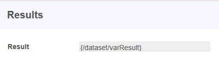

How can I show a form called Results used in User Task
Invoke Workflow is updating the variable used in the form Results

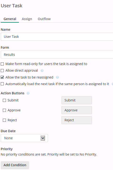

What form did you specify in the user task properties?
replied on June 7, 2016
Results Form

Oh, wait, you're setting the Result field value to {/dataset/varResult} in your form. It should be blank not default to that variable.
I removed  {/dataset/varResult}

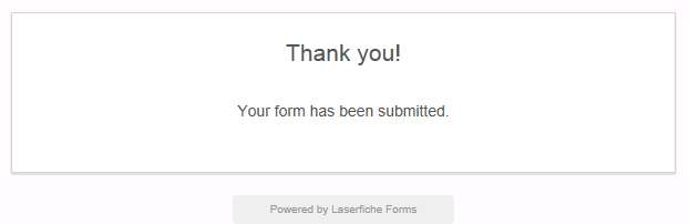

The form Results is still not showing up instead Thanks You Form is always displayed.
Is there any way to replace standard Thank You form with the Results form.
Thanks
But if you go into the Inbox, do you see the user task assigned to that user and showing the Results form with the expected data?
replied on June 9, 2016
Yes, I can the see the Result form with the expected data.
Thanks
Ok, so the process of getting the URL into the form works.
On the start event, you can set it to automatically show the next user task if the same person is assigned to it. That will make it show the Results form to the user instead of the Thank You page. However, keep in mind that this behavior has a timeout of about 40 seconds, so if saving the form to Laserfiche and running the workflow takes longer than that, the user may still get the Thank You page instead. The Results form will always be available to the user in Inbox though.
