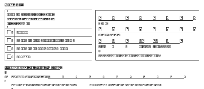

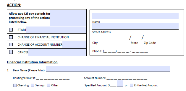

We're having some severe issues with WebAccess' ability to render a pdf accurately in the pdf viewer and it's ability to import and generate pages from a pdf.
All this is done with version 10.1 of WebAccess.
Below is an example of a pdf with out any pages displayed in the pdf viewer. Both samples are taken from the same document, but on different pages. The first one is from page 1, there are about 6 or so boxes and they all exhibit the same display abnormality. The second is from page two and appears how it should.
Sample 1:
Sample 2:

Will the hotfix also improve the rendering within the pdf viewer (what is used to view the electronic file of a pdf, or when there are no image pages attached to the pdf) of webaccess? This still has the same issue as highlighted in the very first example of my original post.
Basically the rendering does not accurately reflect the pdf.
replied on June 2, 2016
The pdf viewer is a separate issue that isn't covered in our hotfix.  Web Access uses pdf.js as the viewer, which is what Firefox uses as its own PDF viewer. Does the problem pdf look ok when opened directly from firefox?
Ok, just tried that.
It exhibits the same rendering issues.

replied on January 25, 2018
FYI, I had the same issue but not on all machines, and only for IE.  I found that setting "Use software rendering instead of GPU rendering" in Tools-Internet Options-Advanced fixed pdf rendering consistently.
