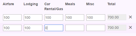

I am using the new javascript in forms 10.1. When I use it in a table, I want to add the values in the rows together to get a total (last box in the row) but when new rows are added, it all adds up together, not independently per row like I want.
How can I use the javascript but not have the rows add up together?

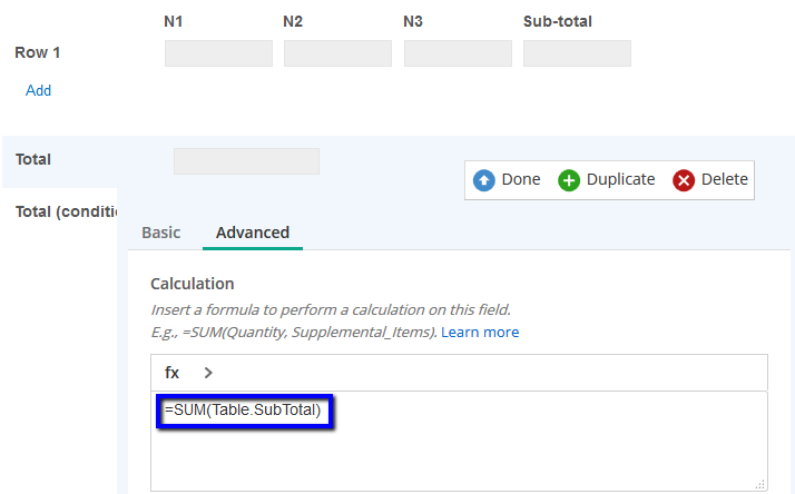

   Is there a procedure for then summing the totals for each value in the Sub-total column for use in another part of the form?
Thanks,
Michael
replied on May 31, 2016
Hi Michael,
Yes you can do that using "sum" function provided by Forms.
E.g.: =SUM(Table.SubTotal)
this will sum the "sub-total" column in each row
and furthermore , you can do this "sum" conditionally using "SUMIFS"
E.g.:
this will sum "sub-total" only for rows with N2<20 and N3>20
