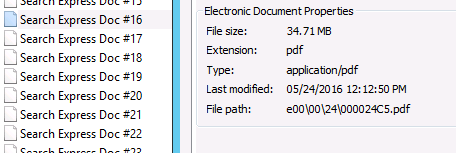

I'm getting inconsistent results when I import PDFs into Laserfiche using ImportEdoc in the SDK. Some PDFs show up with PDF icon and open in the Laserfiche viewer. Others do not get the PDF icon, and open in Adobe. However, both show that they have the PDF extension and the application/PDF mime type when looking at their properties. Here are screen shots for comparison.
The PDFs that show up properly are being exported from a BLOB, and then imported from the file system. The PDFs that don't show up properly are not from the same source, but are also imported from the file system. I don't see why that would make a difference, but it seemed worth mentioning. They all open fine in Adobe. Anyone have any ideas?

The icon in the client is based on the extension only, it does not factor in the mime type (but the mime type should not have spaces). I suspect the extension is being saved as "pdf " with a trailing space.
Try setting the extension on the DocumentInfo after calling ImportEdoc:
DocImp.ImportEdoc("application/pdf", @"C:\Temp\convert.pdf");
doc.Extension = "pdf";
doc.Save();

you can see why laserfiche is not showing pdf icon. ones that are show perfectly have type "application / pdf" whereas those that are not shown perfectly have type "application/pdf".
it seems like there has to be a space between "application" "/" and "pdf".

I tried adding the space, and that didn't make any difference. The PDFs that work are stored as blobs that I'm writing to disk and then importing. The PDFs that don't are already on the file system.
Line used for exported BLOBS: DocImp.ImportEdoc("application / pdf", @"C:\Temp\convert.pdf");
Line used for files already on disk: DocImp.ImportEdoc("application / pdf", (string)DR[1]); where DR[1] is the complete file path to the file, and includes the extension.
The problem PDFs now have the "application / pdf", but the behavior doesn't change.
When I drag and drop one of these problem documents directly into Laserfiche, it does work properly and also has "application / pdf" as the Type.
