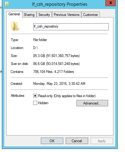

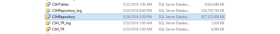

I 'm working on Laserfiche Rio 9.2 and have a database file of repository named "CSHRepository.mdf", size about 900 GB.
But the repository location which has volumes has size about 90 GB.
I noticed the database file grows up so fast. What happened?

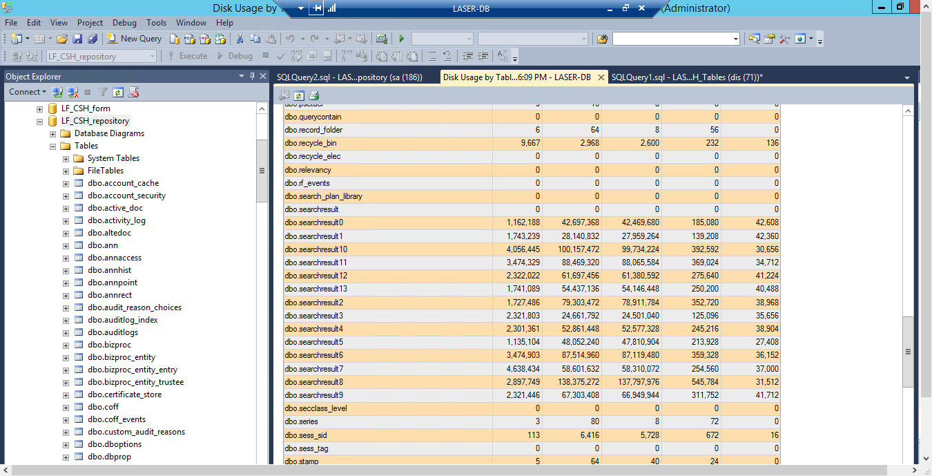

You could also generate a report for disk usage by table from SQL Management Studio, which would give us a better idea of where the space is used and whether it's normal or not.

      As your mention,the disk is now empty then I just can get image of the disk usage by table report.
I noticed that all of table named searchresultX have a bunch of records. How can I decrease the size of database without any side-effect to  all data of the repository.

Now I can get the Disk Usage by table file as attached file.
replied on May 31, 2016
Looks like your users are running very broad searches that return lots of hits. Audit Trail might give you more indication on who and what searches are sent to the Laserfiche Server (if you had it set up log searches).
The tables are cleared out as the user moves on from looking at search results.

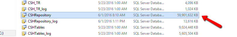

Thank you for your suggestion. Now I had done 'shrink database' and found that the database file get much smaller and it seems that the situation returned to normal.
Currently, the database fie size is about 59 GB.
