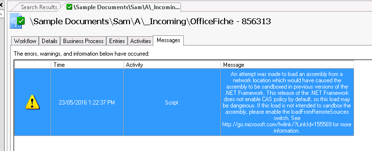

Hi All ,
I am running a action script inside the workflow to write some values in a csv file.
When I execute the workflow it gives a warning message stated below and the script action is not executing
I found this warning message under Workflow designer "today's activity --> message"
warning message : "An attempt was made to load an assembly from a network location which would have caused the assembly to be sandboxed in previous versions of the .NET Framework. This release of the .NET Framework does not enable CAS policy by default, so this load may be dangerous. If this load is not intended to sandbox the assembly, please enable the loadFromRemoteSources switch. See http://go.microsoft.com/fwlink/?LinkId=155569 for more information."
I have also attached a screenshot <error.png> .
I have also updated my .net framework to 4.5.2 version but no luck.
Please help me to solve this issue .. So i cancontinue building and testing my workflow.
thanks in advance ...

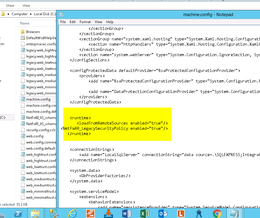

replied on May 24, 2016
Please try adding the loadFromRemoteSources element to machine.config file per here.
replied on May 25, 2016
Hi Xiaoxiao,
I checked the machine.config file. It is already there. Please check the attachment <sample.png>
replied on May 26, 2016
Your problem is caused by the other element in that runtime section. NetFX40_LegacySecurityPolicy set to true is superseding loadFromRemoteSources. The security policy for .Net 4 is off by default. Can you turn it off or explain why it was turned on? There is no way to specify exceptions for it, so Workflow will not run with it on.

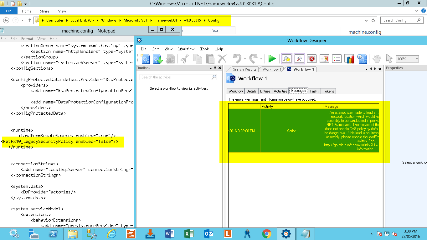

Hi Miruna,
I have set that NetFX40_LegacySecurityPolicy to false but even then the same error comes.
replied on May 27, 2016
Can you double-check that you don't have multiple machine.config files and then restart the WF server?
