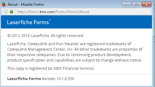

Thanks, for the response Blake!
Looks like I have the correct version - any other ideas?
