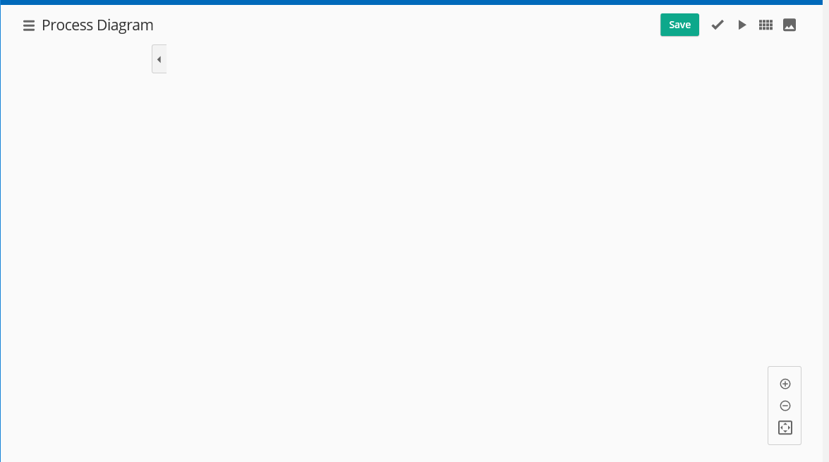

I've a series of forms with an associated process diagram. Suddenly the diagram will no longer load.
  • In Firefox I get the message:
  • In Chrome:
    • The following page has become unresponsive. You can wait for it to become responsive or kill it. Process Diagram | Laserfiche Forms
  • In Microsoft Edge:
    • Laserfiche is not responding due to a long-running script.
I've attached a screenshot of the page, which is pretty much how it looks in all three browsers. I'm able to access the forms themselves just fine.
Has anyone experienced this, or know how to resolve/restore the affected process model/page?

replied on May 18, 2016
Hi Michael,
We've fixed the issue with the business process that you provided. You can get in touch with your VAR and they can get the file for you from the support case we created. If you'd like me to send you the file directly, I can email it to you or provide it to you through some other means.
Hi Michael,
The issue appears to affect business processes that have multiple stages where there's also a subprocess in that stage. For your specific business process, we had to modify the "Submission" stage as that was the one with the issue. Do you recall what may have been done with that stage just before the issue occurred? That will help our development team determine the root cause.

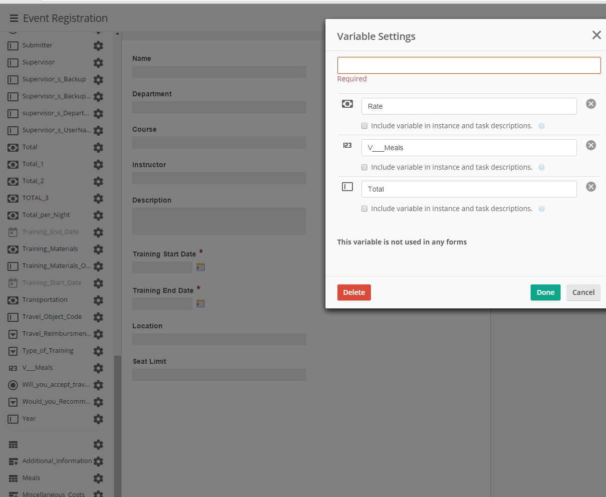

replied on May 27, 2016
Hi Michael,
    I checked your process and found it is caused by a table variable with no name. Please go to the variable tab of any form in this process and set a name for this table variable and save. That will fix this issue.
replied on May 31, 2016
Thank you very much! That fixed it. Was driving me crazy.
