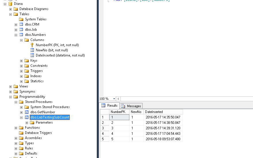

Please see the attached Screenshot, which shows how the database looks, I have the Stored procedure made, however I don't know how to make it propagate into Table?
My Database name is Diana & so is the process name, I have put it appropriately in the script, please confirm it's correct.
Then in the Lookup I set up column result to : count
Unfortunately, after all these it's not showing up the number.
Can you please help, what am I missing?
Thanks in advance,
S

replied on May 18, 2016
Hi Sahil,
Don't use the Diana database; use whatever database is configured in the Forms configuration page under the database tab. The idea is to query Forms data directly to determine how many submissions have already been made, then increment that value and display the (formatted) result. It does not actually query the Diana database with your other lookup data. However, I do highly recommend to not create the stored procedure directly in the Forms database itself.
So the setup is: in Diana, create the stored procedure. In the stored procedure, reference the other Forms database, not Diana. It should work then. The only other caveat I can think of would be if you are not on Forms 10.1, the database schema is slightly different but I do not think any differences will affect this procedure.
Hope this helps!

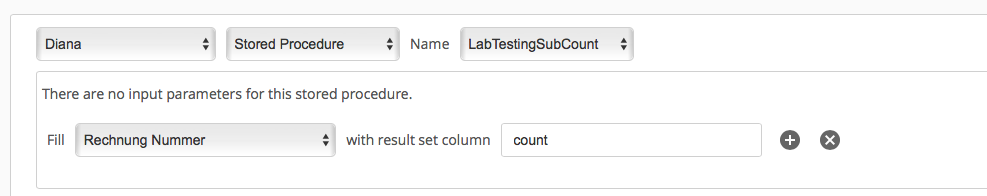

Hi James,
I could not resist & tried, but again it doesn't populate the number :(
Please see attached screenshot for how I have configured the Lookup & the Stored procedure, the forms DB's name is Forms
Laserfiche Forms Version 10.1.0.559

Any suggestions what am I missing?
Thanks
S
