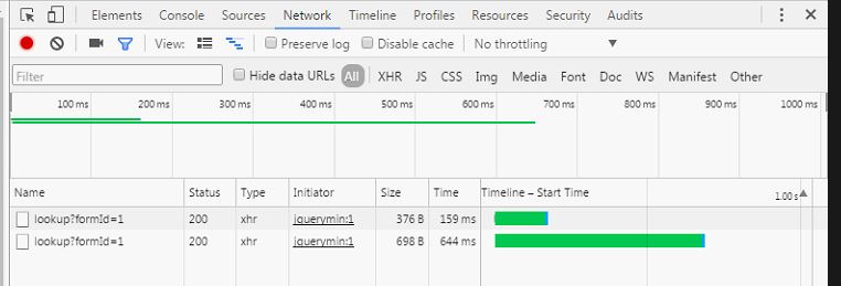

I taht the network tab in dev tools open and it showed the following instantly, but took 40 seconds to show 35 rows.
I will work on sending a video also.
