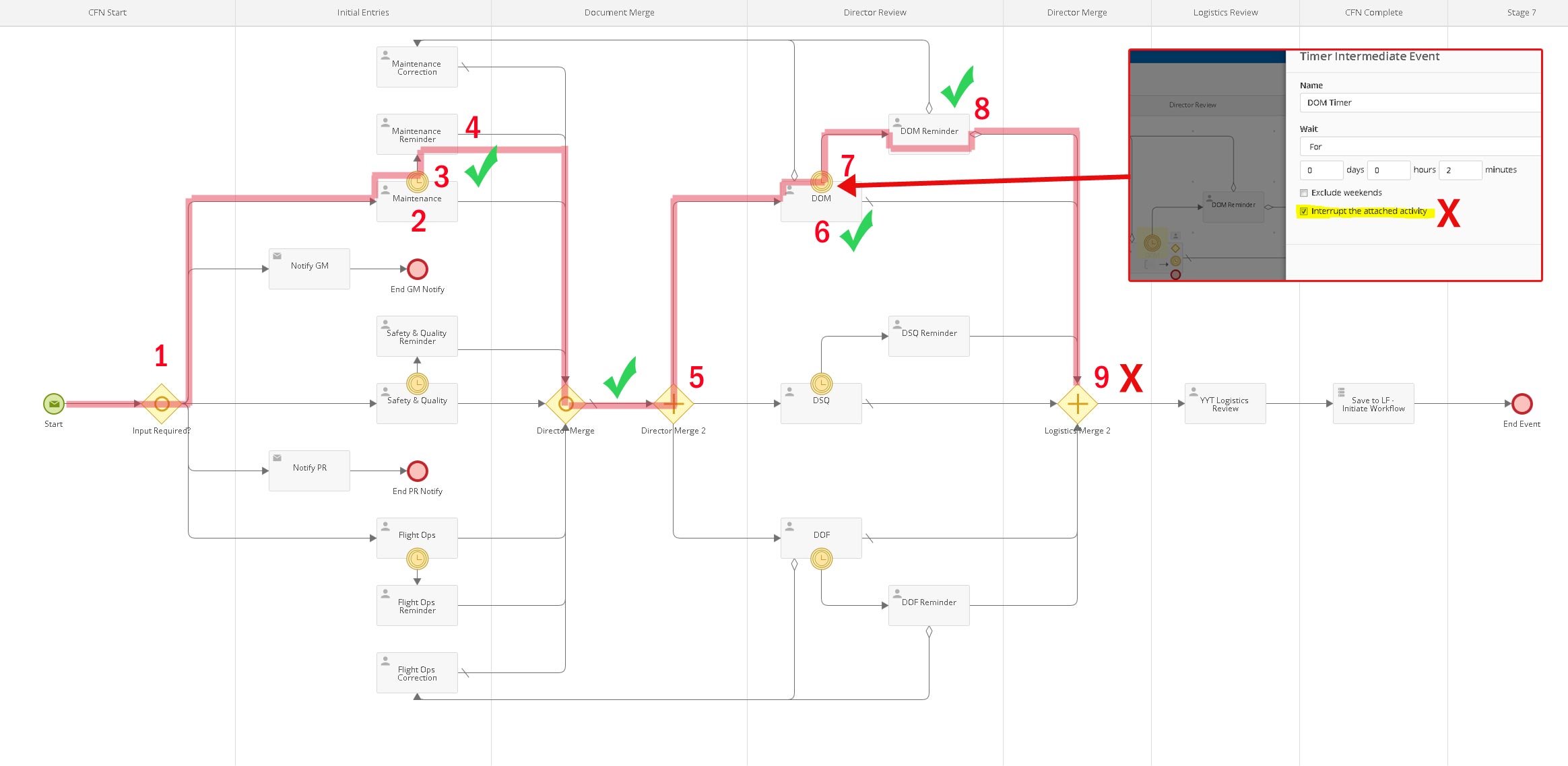

My process utilizes Interrupt the attached activity multiple times. In the attached image, all Attached timer event under Initial Entries function correct (#2 thru #4).  Actually, all items I've numbered 1 thru 5 function. Gateways function at the Director Review section and each Director receives his form.
The issue is at #7. The timer fires on #7 (DOM). As you can see the "Interrupt the attached activity" is checked. After 2 minutes (testing timeframe) the DOM Reminder is sent. The previous DOM task displays as Interrupted in the Process Instance. I click the link received from the #8 (DOM Reminder), all good. No errors are given, the process does not fail but the forms do not merge at #9 (Logistics Merge 2) and I do not receive notification at YYT Logistics Review.
To recap, #1 thru #5 function as designed, with or without timers. The forms merge and at the first set of gateways. #6 is OK (DOM, DSQ and/or DOF). #7 timers triggers but the attached activity is not interrupted. This process runs smooth when I eliminate the attached timers at the Director Review
Am I doing something wrong? Why would the first set of timer events function and merge but not the second set (Director Review)?

  1. You said "The previous DOM task displays as Interrupted in the Process Instance", so the timer actually interrupt the attached user task "DOM" right?
    Yes
  2. The issue is that the parallel merge gateway "Logistics Merge 2" does not work as expected right?
    Correct. After an approval or timer triggered at DOM, DOF or DSQ User Task, the process ends without error, nor does it proceed to "Logistics Merge 2".
    If I delete the attached timer events from DOM, DOF and DSQ then the process progresses to "Logistics Merge 2" and "YYT Logistics Review"
  3. It's because there are 6 inflows for the "Logistics Merge 2" parallel gateway, so it will wait for 6 inflows then it will process to next step.
    But isn't that the purpose of the Attached Timer Event with Interrupt the attached activity enabled? No matter what occurs, with Interrupt the attached activity enabled on the 3 timers, there is in reality only 3 inflows to "Logistics Merge 2"?
    Also, there are 6 inflows to the Director Merge gateway after the "Initial Entries" stage.
  4. You can change the "Director Merge 2" and "Logistics Merge 2" to inclusive gateway as "Director Merge": so the "Logistics Merge 2" will be completed when the inflows actually reach to it equals the outflows of "Director Merge 2".
    I'm confused. Are you saying that between 2 gateways, the outflow and inflow must be equal?
Either way, I made the changes you suggested and I still do not progress to "Logistics Merge 2" and now the process shows as "Terminated" without an error log.

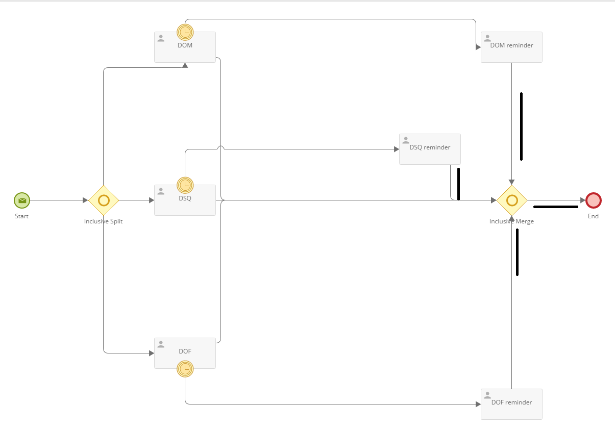

 I created a similar process and the process can go to End event after the inclusive merge:
Please open an support case with exported XML for the process if you still can reproduce this and we need to know which paths are taken when get this error.

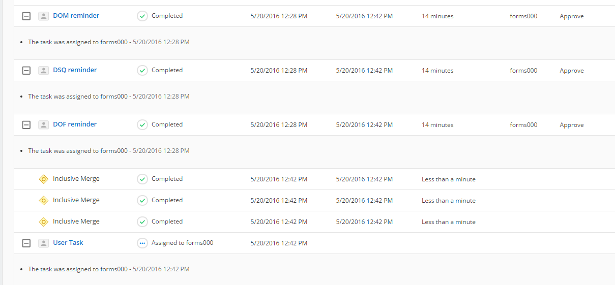

replied on May 19, 2016
I add a user task after the Inclusive merge gateway, it can goes to the user task as well.  See instance history below:
 It should not matter what's object type for the step after inclusive gateway.  Can you try remove all the inflows and outflows of the Logistics Merge gateway and re-add them?
