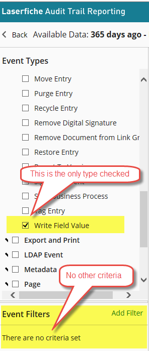

I found the information you are talking about and created a report that only shows the audit logs with an Event Type of 'Write Field Value'.  I have no other filters set in the report.  The report only shows the field changes made by me.  Since I have no filters set in the Audit Report I am assuming this means that only field values changed by me are being logged.

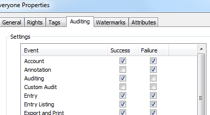

I have checked the "Entry" in the auditing tab for the Everyone group so I would expect to see field value changes for all employees, not just myself.   Is there something else I need to change in order to have audit logging to occur for everyone?
replied on May 13, 2016
Look at the properties for the individual users and check under the "Auditing" tab to see what the audit settings are set to. It should be "Group membership" if you want that user to follow what you've configured for the Everyone group. Otherwise, it will use what's been manually set at the user level and from there, the entry events may not be selected to be audited.
