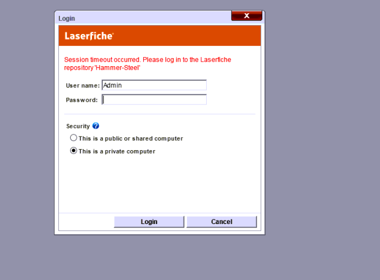

If a user logs into web access, is finished, logs out. Then they log back in they get an error. Session Timeout occurred. Please log in to the Laserfiche repository. They cannot log back in until IIS is reset. Then it happens all over again...

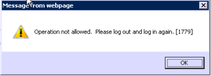

replied on May 13, 2016
Here is the error that we get when they try to log back in. Again, they are clicking Log Out at the top right of the browser. They are not just closing the browser
you can then click logout, but when you try to log back in it keeps popping this box up

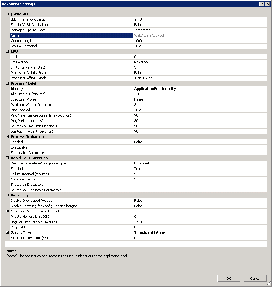

Hi Casey,
Could you open IIS, go to application pools, right click on WebAccessAppPool, click Advanced settings, and check the Request Limit? The value should be '0', which means the app pool can process an unlimited number of requests.
replied on June 9, 2016
It is already set at this. Still getting the above errors.....
replied on June 13, 2016
Fixing the WebAccessAppPool Maximum Worker Process in advanced settings from 2 to 1 fixed the issue
APPROVED ANSWER
replied on June 13, 2016 Show version history
A support case had been opened for this issue and it was pointed out that web gardens aren't supported. Changing the maximum worker processes to 1 resolved the matter.
