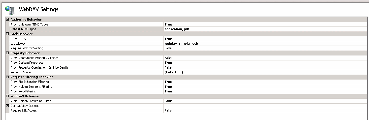

I am using WebDAV to pull PDF's to an Incoming Documents folder that WF monitors for PDF's to run. I followed the WebDAV configuration in the LF adminisration guide. The mapped drive is \\laserfiche\DavWWWRoot. The server is 2008 R2, WebDAV is installed and I setup Authorizing Rules for All content, All users, permissions to Read, Source, and Write. Workflow will not kick off as it does not see the document as a PDF - the activity error message is 'The entry was not a PDF. PDF activities will only run if the entry is a PDF'. Looking at the properties- the extension is PDF but the type is empty. The PDF is saved with the extension .pdf. I've changed the WebDAV setting default MIME Type to application/pdf and the Type on the file is still empty when putting the PDF in. Any suggestions on how to get the MIME type to populate?

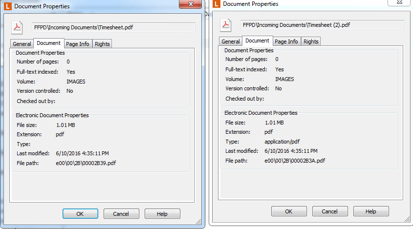

Hi Miruna,
Actually I think this has to do with the MIME type because when I add the same file using the LF Client, the type is set properly (on the left, pdf added through WebDAV, on the right the same file dragged into the LF Client):
I will open a case with support on this though. Thanks Miruna!
