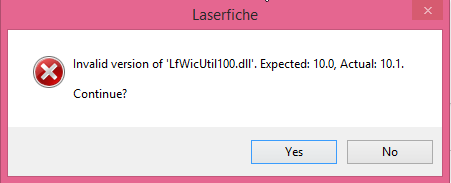

I tried to view a doc file in webaccess which pointed out that i should install LF Office Integeration. But when i installed it, LF Client generates an error every time i start client.
From the error it seems like LF Client was expecting this utilities dll to be of version 10 but it is 10.1 instead. I believe office utility updated this dll but not the client.
How can i resolve this issue. Would installing 10.1 update have any impact on client.

The issue appears to be a bug.  The SCR for reference is 143459.  For now, please click on "Continue."

This is a known issue, you can click Continue and everything will be fine. It's not due to any installation related scenario or interaction between different products, just your average run-of-the-mill bug. We'll have it addressed in an upcoming Client update in the near future.

An update to my prior post, I rechecked the SCR listing and updating the Client itself to 10.1 should also make the message box go away, as that particular check is already removed from the 10.1 Client.
