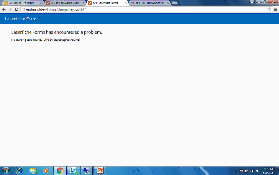

Hi,
I have developed a four step process that I need to deploy to a different server. On deploying I get the error that "No starting step found". I get this error when I try to open the initial form. The process has three other forms whichare opened ok apart from the starting one. I get the same error when I try to submit the form. What may cause this. This is Forms 10. Image attached
Mark

replied on May 10, 2016
Correct, you can't transfer processes from a higher version to an older version of the software.
replied on May 16, 2016
For this "No starting step found" error, you can go to process diagram and save the process again, the the process will be saved with 10.0's format and will be able to run with 10.0.
Hi Xiang,
Thanks for the update. I however resolved it by changing the starting forms to another one, saving the process and then returning the starting form again and saving it.
Regards,
Mark
