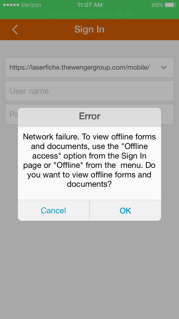

Can't seem to get in using mobile 10. This is an iOS device. doesn't seem to want to recognize the cert? Tried every variation we could think of and it continues to give the network error. any ideas about what might be going on here? This is the first time this is being setup and mobile is on the latest version of 10. Everything appears to be configured correctly in the mobile configuration page. I'm not all that knowledgeable with certificates but could it be something with that?

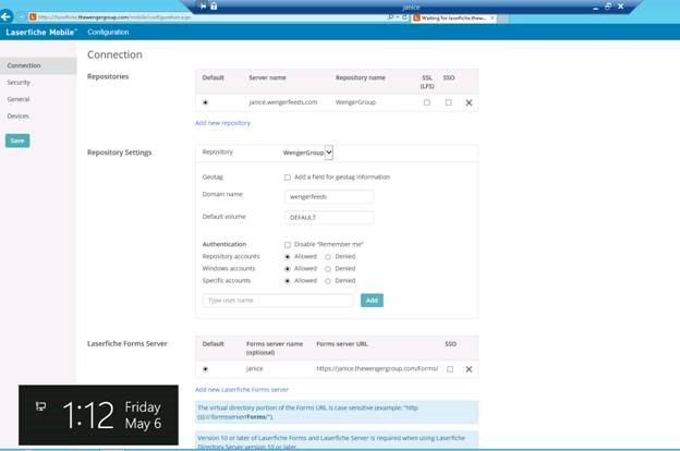

also, here is a screen shot of most of  the configuration page. I'm not sure how clear that is going to come in though. if you need a better image let me know.

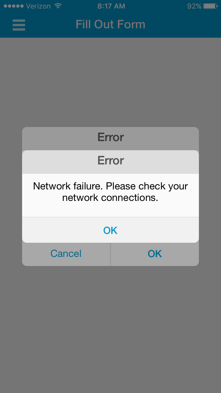

firewall was configured and we were able to get in ok....once in mobile the same exact thing pops up for trying to use forms. are there other firewall setting for forms to be aware of or could this be something entirely different? thanks for all your help on this!
