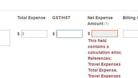

replied on January 20, 2017
I'm still running into this issue. I am running 10.1.0.642.
Here is a picture of my table
Here is a snap of my formula:
=SUB(INDEX(TRAVEL.Total_Expense_2,ROW()),INDEX(TRAVEL.GST_HST_2,ROW()))
Here is a snap of my error when 1 field is blank:

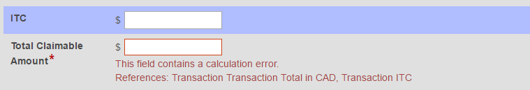

replied on August 31, 2017
I just attempted to get two currency fields to subtract from each other using the SUB option and kept getting the same error.  I ended up having to use SUM but multiply the 2nd value by -1 to get it to work as subtraction.
  •  =SUM(Currency1,PRODUCT(Currency2,-1))
