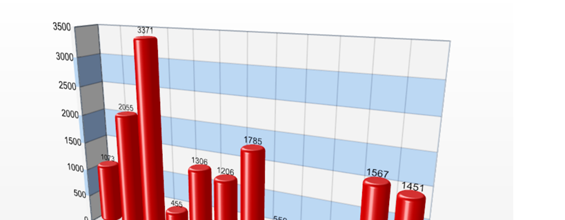

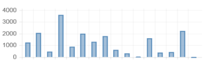

In previous version of audit trail when making a graph report the graph would have the total of the columns at the top. Currently with version 10 this seems to have been removed. Is there a way to add this feature back in?

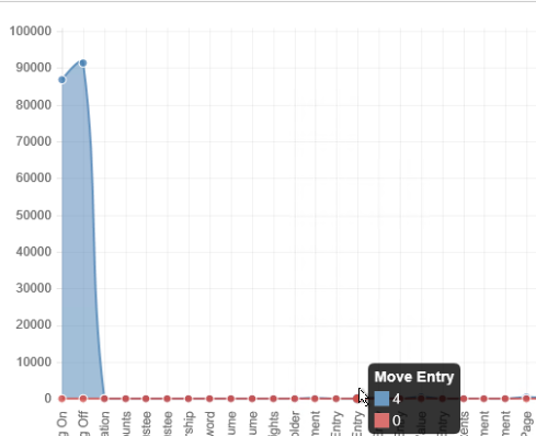

The behaviour has changed in Audit Trail 10 and 10.1, now the total of each column is shown in the tool tip when hovering mouse over each column (or when hovering over each data point in a Line Chart).
