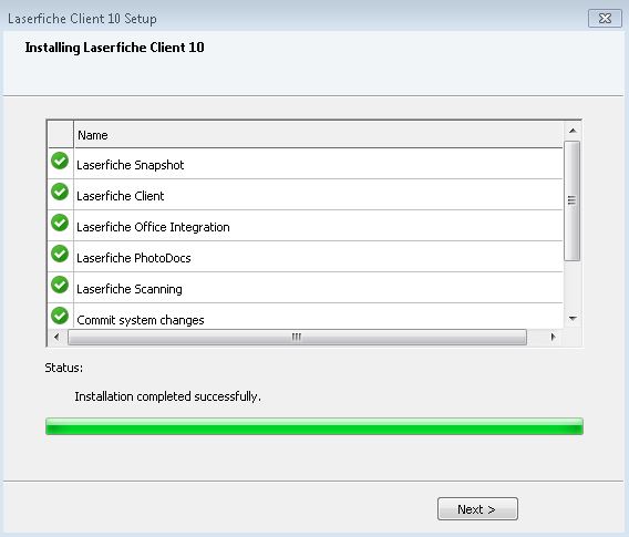

I am trying to do a silent install of the Laserfiche 10.1 Client by using a batch file via PDQ Deploy.  When pushing out the batch file using PDQ Deploy, the client installs but the job doesn't complete, it just hangs.  So I ran just the batch file and it gets stuck on the "Next" screen.  So I must be missing something, but haven't been able to figure it out.
Here is the command:
"\\SERVER\Installs\Laserfiche Media\Laserfiche 10.1\en\Client\Setup.exe" -silent -noui -iacceptlicenseagreement -log "C:\Logs\LaserficheClientInstall" INSTALLLEVEL=300
I attached a screen shot of the "Next" screen.
Any thoughts or suggestions?
Thanks!
replied on May 3, 2016
It looks like the installation is in fact completed successfully, it's just not skipping clicking next at the end. I assume if you manually click next everything is complete? If you truly want a silent install, you can try the -silent paramater on it's own. -noUI stands for 'no user interaction' (not no user interface), and will override silent if both are present.
replied on May 4, 2016
That did the trick!  I successfully completed using the batch file.  Then I ran it from PDQ Deploy and that also completed.  Thank you!
