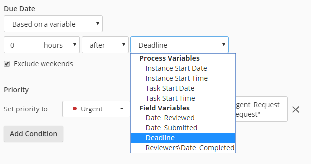

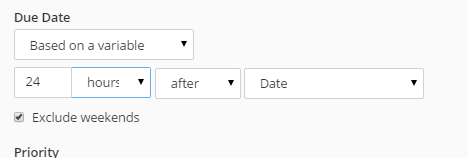

We have a customer that needs to measure if they hit deadlines mandated by the state.  They  have a 24 hour deadline to respond to items after a Preliminary Date and Time is agreed upon.  I have the deadline set to 24 hours after the Preliminary Date variable in Forms.  However, the Preliminary Time is not a variable that I am able to add to set the Deadline.  The system automatically uses midnight at the deadline time.  For example, if I set the Preliminary Date to May 3rd.  Forms sets the deadline for the task to May 4th at 12:00 am.  We need it to be 24 hours from the Preliminary Date and Time. Is there a way to set this somewhere?
replied on May 3, 2016
The due date in Forms 10 can only based on Date variable, you can set it to 24 hours after a date variable, but value from customize time field can't be configured.
Forms 11 will add time field and time variable can be used in due date as well.

Hi there-
I know it's not version 11, but I was hoping hour-based deadlines would be available in the 10.2 release. Am I missing something? I don't see my time variable as an option for the deadline.
Realistically, I only need the number of hours to be able to populate from a variable, rather than being hard-coded.
replied on January 20, 2017
So you want to the value before hours to be able to use a number variable instead of use a time variable?
With Forms 10.2, what is supported is, you can add a date field and enable "Show Time" for it, then you can configure to be 24 hours after a specified date and time.
