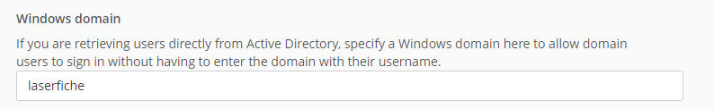

Basically, if your Windows domain section is configured correctly in formsconfig, you should not need to provide the domain at all. You should only need username. The formatting for this configuration should not be the FQDN of your domain and should only show be domain part of your domain\username login.
replied on April 21, 2016
Correct, just our normal domain is in there as it should be.  Before it stopped working we had to have the domain\ in the usernames.  Does not working with either no domain in front or with.

Your Forms server is configured to "use Laserfiche Server authentication"?, have you checked whether the windows domain is configured in the User Authentication tab from Forms Configuration site?
