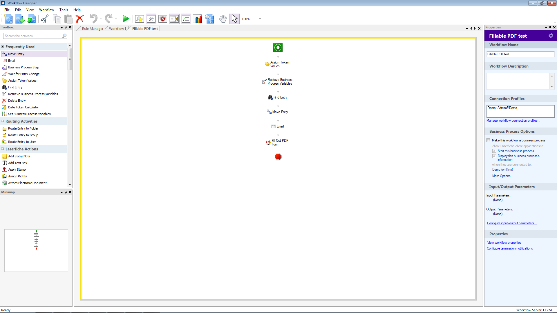

Can you send a screenshot of how you have the workflow set up to pull the information?
replied on April 21, 2016
I have a little extra processes in here for testing.
Token Value: This is for testing. Not essential.
Retrieve Business Process Variables: This is the process to pull all the form data.
Find Entry: Finds a blank fillable PDF ready to be populated.
Move Entry: Copies that fillable PDF to a new space.
Email: This step is for me to verify that the workflow is working correctly when the starter is the form its self.
Fill out PDF Form: is what it is.
Fillable PDF.png (93.99 KB)

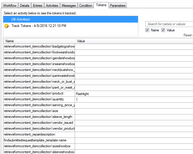

As a general rule, I have started using the Track Tokens activity in every workflow even if it doesn't have tokens.  It gives me the Tokens tab when I look at past instances of the workflow and I can verify that information is coming in from the form.
My suggestion would be to add the Track Tokens activity at the end.  Test it again.  Open up the instance and look at the Tokens tab to make sure the information is coming in from the form.  If it is coming in but not filling the PDF, then try putting the information from the form in tokens first and use the tokens to fill the PDF.
replied on April 21, 2016 • Show version history
Im not sure how to pull token information when the workflow is built to pull data from a Laserfiche form.
I had tried what you suggested but to test I have to fire the workflow from the forms process rather than the play button within Workflow Designer.
Either way I tried to dump the tokens into an email body that is sent back to me. It too is also coming back blank. This workflow is starting from a forms process and its supposed to capture data form the forms fields. Its not doing that at all.

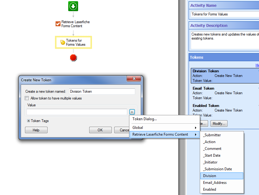

This is in 9.1 not 10 but should give you a fairly good idea.  Set up the activity that retrieve the information from the form.  Then create a token for each field you are pulling back.  Put the form information in the tokens.
replied on April 22, 2016
They come back blank.
