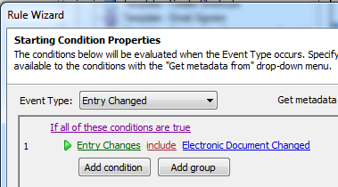

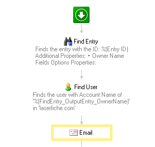

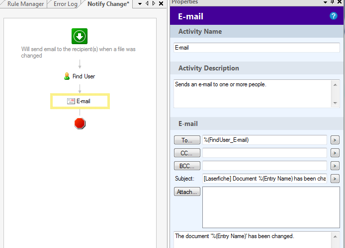

My goal is to send a notification email to the person who started the workflow on a specific document when someone else has changed the document ("electronic file", mostly MS Word file). I tried 'Find User' and 'E-mail' tool as below and set up a Starting Rule. But it does not send email. What would be the correct way to implement this? When I "start Business process" on a test document, the workflow just starts and terminates right away. How do I make my workflow wait until the document is changed? LDAP Trustee Directory is setup correctly (at least I believe). Thanks,

I'm not sure what you're trying to do with "Start Business Process". This workflow would start on its own from the "entry change" starting rule you have. You should be modifying the document to trigger it.

So, when the workflow starts, we need to get the owner property. We can do that with Find Entry.

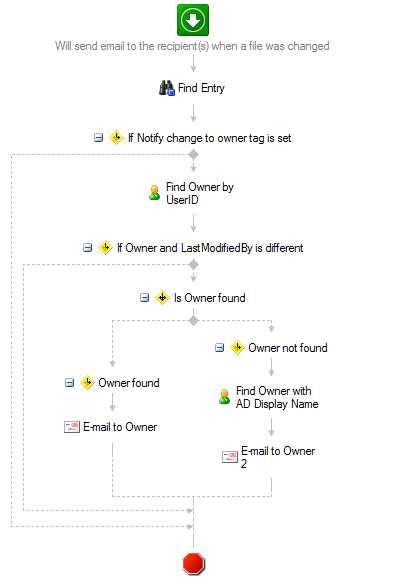

I finally managed to make my workflow send automatic notification when a document is changed (Thanks Miruna!).

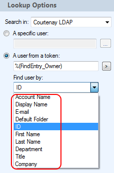

Comment about the Workflow Designer: In 'Find User' tool, the options for AD attributes are somewhat limited. I used ID (userid, samaccountname?) and 'Display Name'. This means I have to force my users to enter owner name with only Active Directory User ID or Display Name. In many cases, they already entered owner field with just common names format like 'Firstname Lastname', while our AD's Display Name is in the format of 'Lastname, Firstname'. I wish there was one more option of "FirstName LastName" in workflow designer.

As far as the user properties you can search for in Active Directory, we only added the more common ones. You can define custom properties though and Workflow will pick them up. See the section on custom properties in this help page.

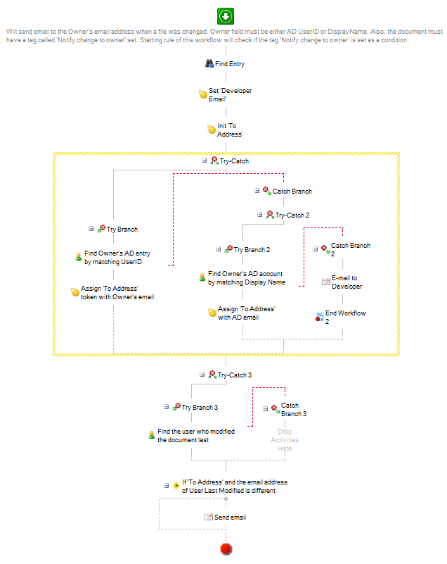

By the way, I realized that when 'Find User' failed to find one, it seems just to errors out and stop the whole workflow and does not move to the next step in spite that the next conditional decision does have an option of "Has Result". So, I am trying try-catch block now. Is this normal behaviour? If so, wouldn't it be better not to error out when there was no match?

This is the final working version for the record:
Using try-catch block every time 'Find User' activity is used is rather annoying. I wish this activity has an extra option such as "Ignore no find error" or something.
