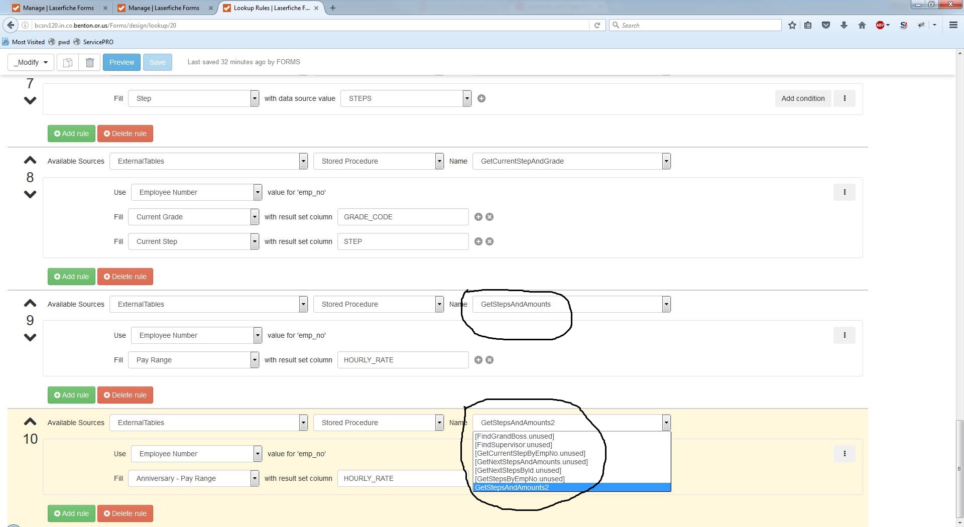

I have a stored procedure I'd like to use for multiple fields on a form.  However, I've found that once I use it as a Lookup Rule for one field, it is no longer in the drop down list of available stored procedures from the server.  Is this really a restriction, or am I doing something wrong?  If it is a restriction, why?
If I can only call it once, can I load a variable with the results, then use that variable elsewhere in the form?
I've attached a file with a screenshot showing the item selected in one rule, but not available in the other.  I worked around the problem by duplicating the script and calling it [ScriptName]2, but that's a hack.

It is not restricted in Forms 9 actually: In Forms 9, the UI is to group lookup rules for same data source, if you want to add multiple lookup rules for same stored procedure, you can click the button after the first rule to add more:
0 1
replied on April 18, 2016
That's not the same issue at all.  Your example shows obtaining multiple return values from the same call to the stored procedure.  I need to call the procedure multiple times, for different fields on the form.  Laserfiche Forms is only giving me the option of calling it once.

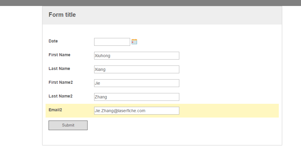

It does call the stored produce multiple times for multiple rules, see following screenshots for example, the stored procedure has a input parameter which is FirstName, for different rules, I input different value for the input parameter and get different results:
replied on April 21, 2016
Thanks!  That does work, but is sort of counter-intuitive, when the fields are on different positions on the form, and are conditionally hidden.  Now that I know it works that way, I can likely work with it.  Thanks again.
